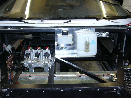

Re: DAX Build Up
Bracket for the Fluid Resevoirs (Brake and washer) and brake pedal masters fitted (Double thickness windscreen as Paul's is on top when his car is at the painters. Also visible is the windscreen wiper mechanism not installed
