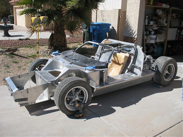

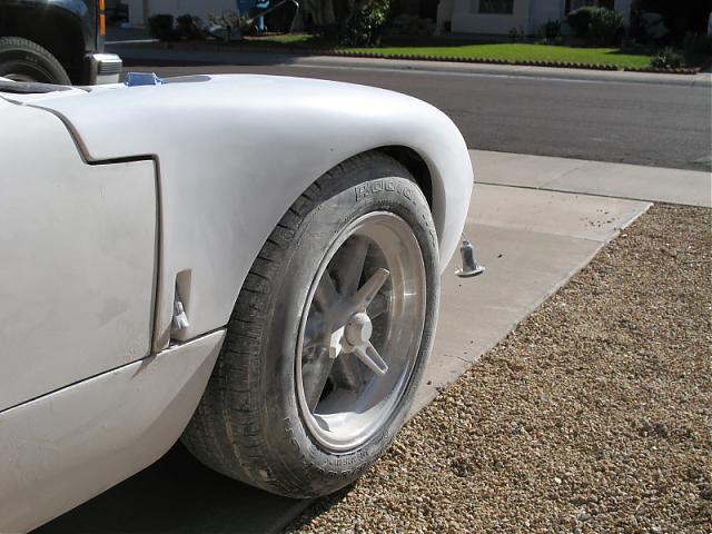

Fran sent me a few pics and I thought I'd share them. Not huge news yet, but the anticipation is truly building. My schedule necessitates delivery in January but it'll still be a Merry Christmas!
Looking forward to starting the actually build portion of the build thread!
Happy holidays to all,
Chris

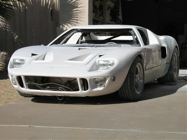

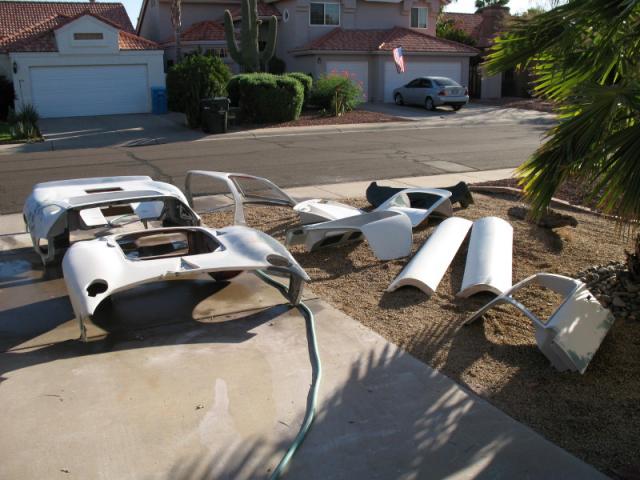

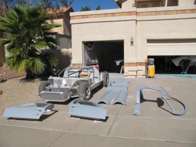

Spent the rest of the time with my dad working on final alignment of the body since I had the extra set of hands. It was quite interesting. I've never done this sort of thing before and obviously it's complex.
The panels are very accurate, down to the asymetrical features which make "alignment" a bit of a misnomer. I figured on this and pretty much carried on with the business but wondered if I was doing the right thing. This is the first time I've ever done such a feat.
My dad and I got through it and had the spider aligned- or so we thought. We started with the front and rear clips and had to re-do a lot of our work. I was getting a little... frustrated. I pulled out the phone in a moment of desperation and put a call in to Hersh. I left him a message saying I needed to validate what I was doing and asked if he'd be willing to swing by. The work week came and I let it go for a while.
Hersh was by Thurs and we started back from scratch, ironically getting just about right back to where we started. That's when he gave me the "it's a 1960's racecar and it's not square" speech. We (he) got a fit I am happy with. I will need to close up some gaps on the doors though as I put any errors there and left the spider & clips as close as I could to original.
Right now I am working on the doors and getting them to hang and swing. Holy crap it's a pain in the butt. And I absolutlely massacred the passenger door handle as well. I'm sure people who've built them already know this but it's a little difficult to get a drill bit in there to get the hole for the pivot drilled. Any recommendations before I deface the driver's side? What tool do I need?
Beyond that, positive motivation has been found in the driver's seat. I truly FIT!! I am 6' 2" and was concerned about sitting and fitting with a helmet. I have found a comfortable position where I see over the dash, with a half inch above my helmet, with room for a cage, a clear view of all gages, legs fitting nicely in the footwell and steering wheel right where I want it. Fran hooked me up with a seat base that isn't as tall as the normal one and it looks right on for me. I can't explain the happiness as this all came together!
Friday rolled around and I was back out in the garage. The phone rang and Hersh was taking lunch orders on his way over and wanted to know what I'd like. He helped for another few hours as we worked more on the doors and their swing. We also got the dash fitted and worked through a few other issues as well.
Pics follow. It was really nice having the success come to mitigate the frustration! It was even better having the experienced set of eyes and hands around to help a total newbie through the most laborious and time consuming portion of the build.
Again, thanks Hersh.

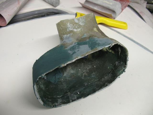

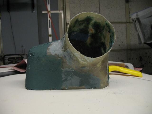

On the door handles I drilled the hole out way to big and then glassed in some pipe to act as a sleeve. I think you can make it out in this picture:

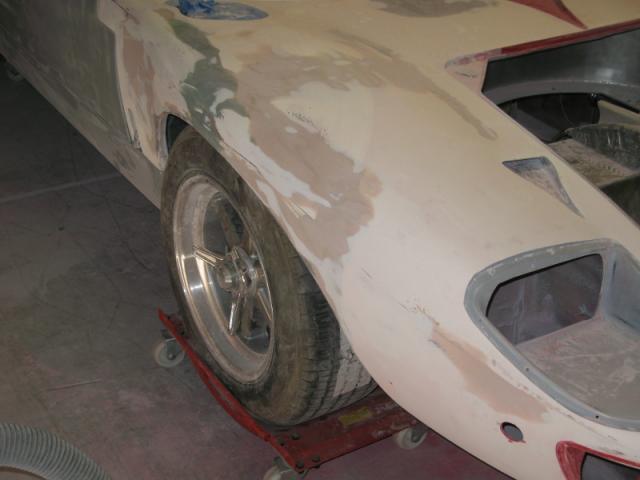

Fran- I picked the car up on 1/10 (you of all people should remember this!) and you're looking at what roughly 2 wks has done (about 8 or 9 days of the car actually residing in the garage). The body work stuff is laborious and can be frustrating but once the doors are finally hung and trimmed, just cleaning up the gaps will be all that's left.
Through all this work however, I am leaning toward actually painting it now- especially if I'm doing the body work stuff. It'll be a learning experience for sure but everything on this project will. I am going to start obsessing about what colors now.
Bill - You might not have the body hung but you're well ahead of me on other issues. I'm sure you'll grow to love it as much as I am. Nice progress by the way.
Jonathan - Thanks for the tips. I have a feeling I am about to become an expert in fiberglassing.

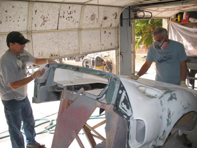

Howard - that's Hersh in the picture and we're in the process of trimming down the dash so the A-pillars can slot in. That saw is getting little use in reality. Between Fran's assembly guide and Hersh's experience, we have arrived exactly where you indicated- as even as possible on the gaps all around the car, with the exception of the doors. I am working on getting them placed precisely and then will fill in the gaps. The back of the door is where it seems largest and will need the most attention. Like you said though, I am confident it will mostly be patience and persistance to acheive the desired results. Thanks for the pointers on the gap fill as well, Gorilla Hair was what Hersh recommended. Any thoughts on that?
I'll be back at it on Thurs, Fri and part of Sat. Time to see how patient I can be.

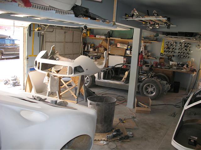

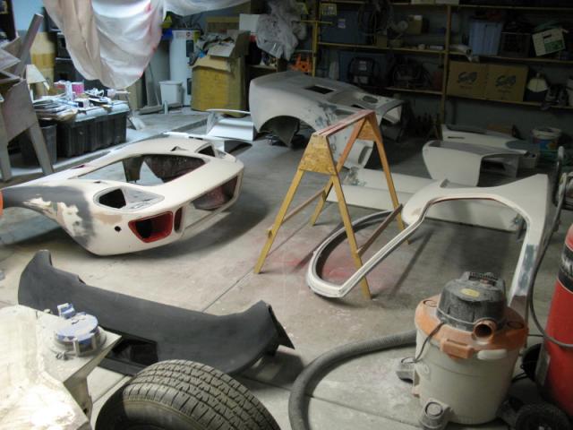

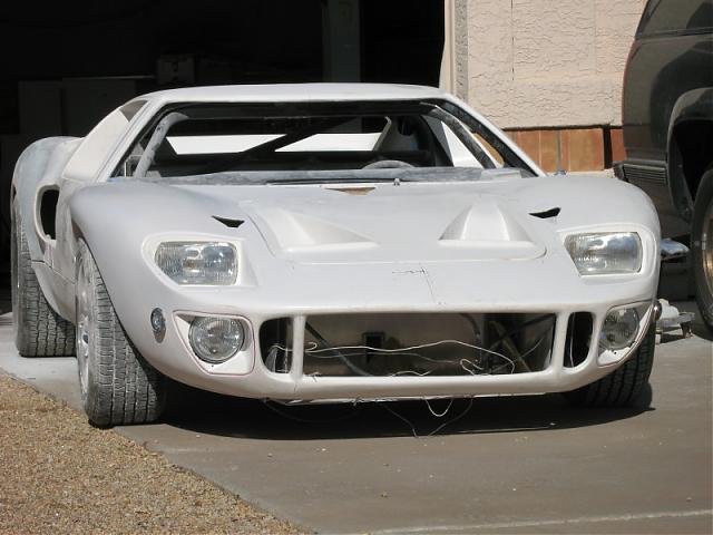

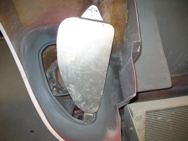

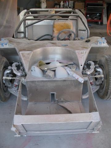

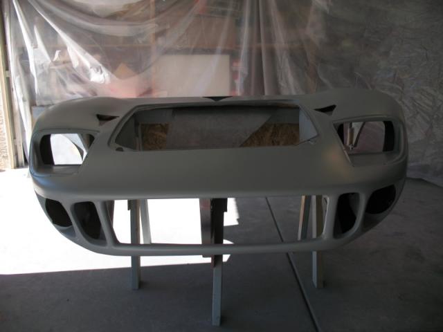

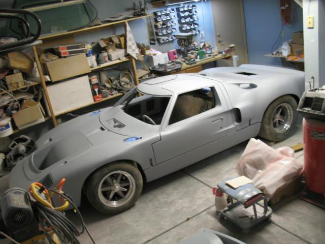

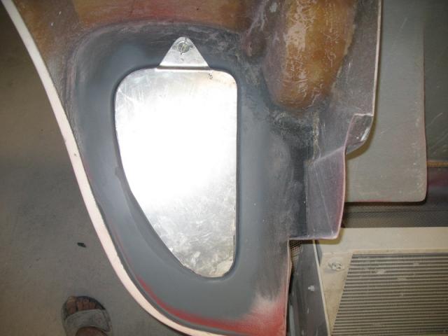

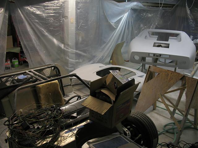

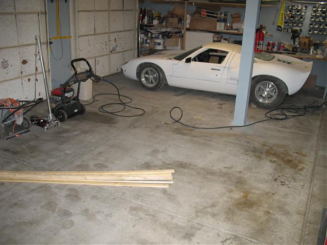

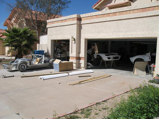

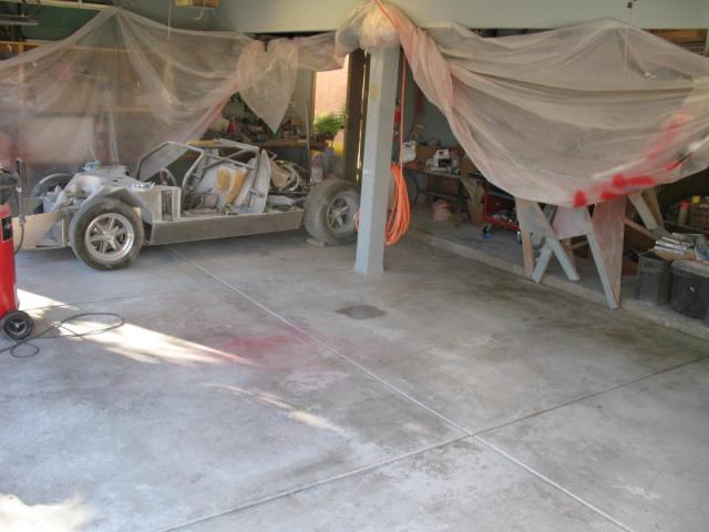

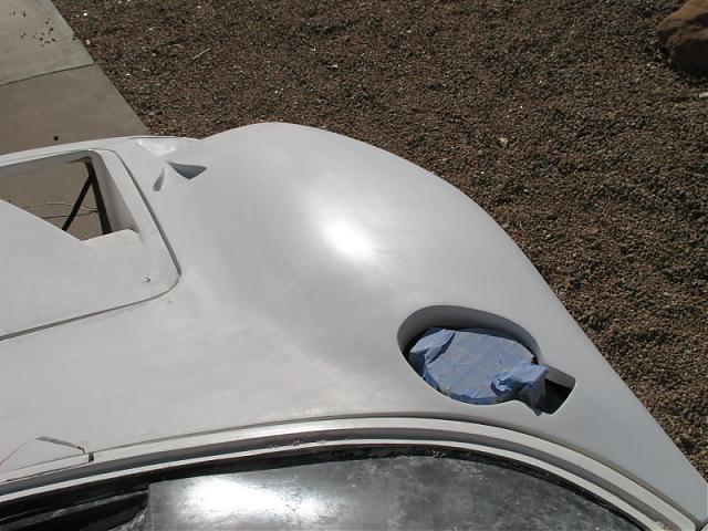

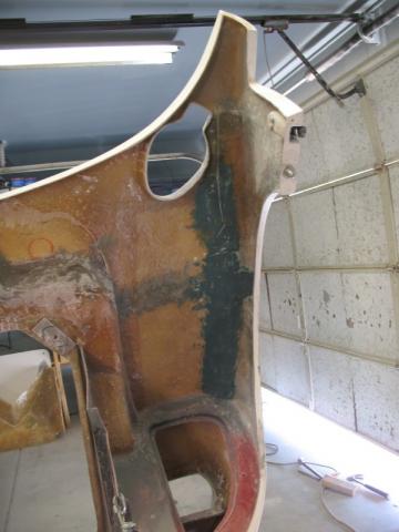

More fun with fiberglass this week.
Gauges in - check
Rear clip vent cut out - check
Taillights installed - check
Pedal box built up - check
Headlamp and driving light covers fit up - check
Headlamp holes cut out - check
Box with bunch of wires in it opened - check (what to do with it next???)
Filler caps located - check
Looking more and more like an actual car - priceless
Also included is additional random imagery, like more wiring mess and my home-made totally ergonomic front clip workstation. Enjoy, and as usual any suggestions appreciated.
Also FWIW, my handheld electric angle grinder did wonders on trimming the lamp covers. It was magical. I stenciled the headlamp openings with a piece of paper and cut it to very near net shape and finished the job with a hand file to trim it up. Work? Yeah, but I did both sides in about an hour and a half (including setup of that high tech egro fixturing).
The wiring and bodywork is what I have been dreading. So far so good, but credit a strong package off the shelf which has so far enabled me to be where I am already.

Re: Rcr40-31
Excellent progress Chris!! You're really coming along. I was going to do my lights this weekend but the rainy weather prevented me from doing so. I see you have your tach rotated 90* also - excellent!
If you need more information on the brake ducts I made, let me know and I'll send my information along.
And any other RCR builders who want the information, just let me know.

Chris Kouba
Re: Rcr40-31
Thanks gents, things have been going rather well this week.
Full disclosure- the lights are in the holes but not yet actually mounted. They're taped in currently but I wanted the gratification of seeing them in the proper place. I'm saving the fiberglassing to be done at one time and I also need to fab up the mounting plates as well.
Regarding the pedal box, I'll need to do a little modding of how the clutch master mounts as where I want it puts the cylinder in the space of the lower left A-arm's front inboard mount. Still thinking up how to deal with that one and I'd be open to suggestions. I will definitely take you up on the P/Ns for the banjo fittings, Ron. That was something I saw as soon as I tried to set the pedals where I wanted them.
Unfortunately the body situating isn't quite finished yet. I have the hinges mounted robustly and the doors are swinging well but I think I can do a little better on their alignment so I'll get at it over the weekend if I'm around.
I'm still a few days from worrying about brake ducting Bill, but when you get a minute feel free to send it my way. Thanks in advance. It looks pretty sweet!
