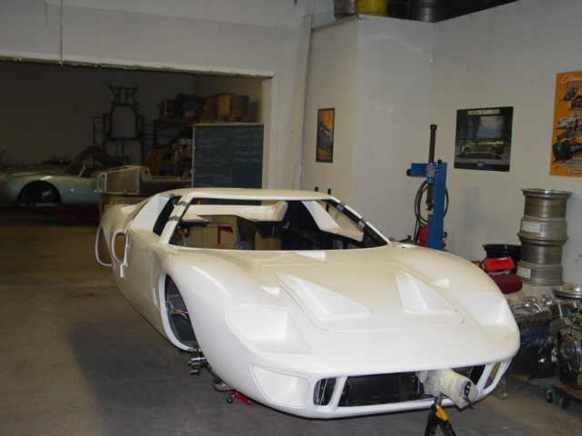

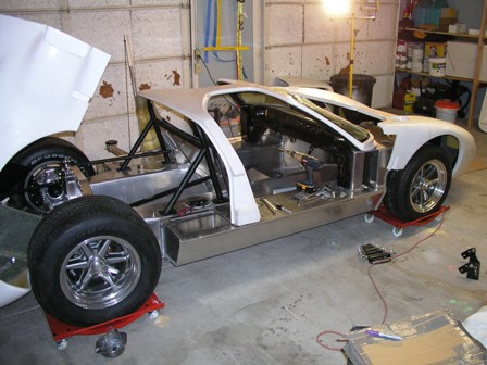

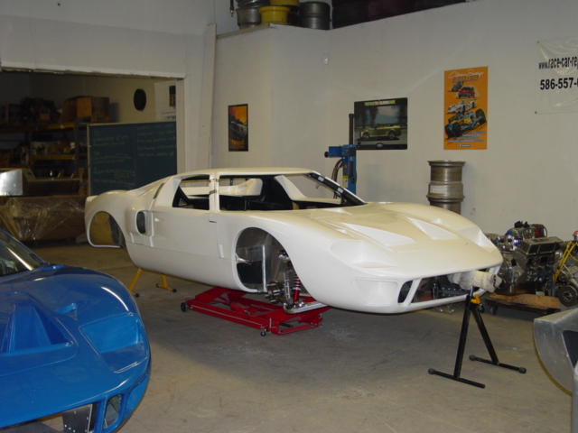

Fran sent me a few pics and I thought I'd share them. Not huge news yet, but the anticipation is truly building. My schedule necessitates delivery in January but it'll still be a Merry Christmas!
Looking forward to starting the actually build portion of the build thread!

Many would agree that there's nothing quite like a couple of pics from Fran to perk up one's day. Very much looking forward to watching your build, my friend.
The only challenge now is finding a way to keep you off that bike until the car's finished...

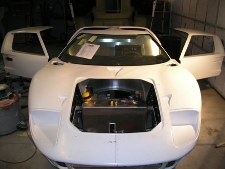

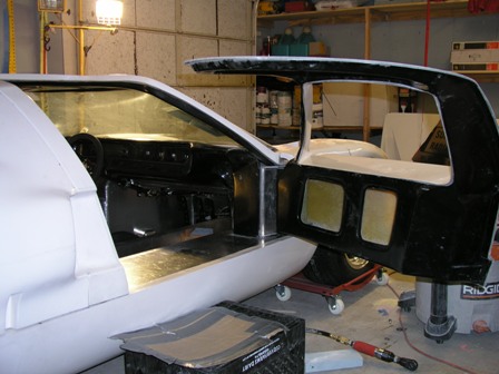

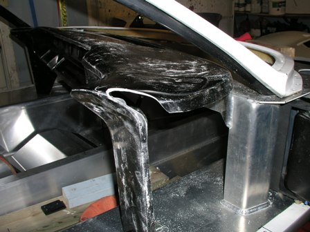

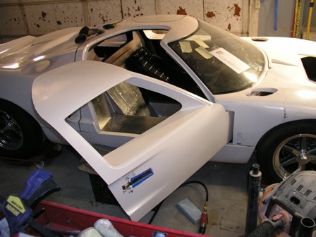

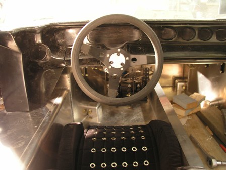

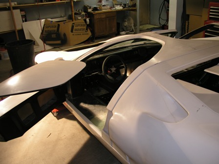

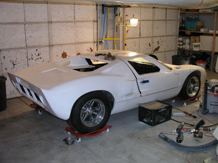

Spent the rest of the time with my dad working on final alignment of the body since I had the extra set of hands. It was quite interesting. I've never done this sort of thing before and obviously it's complex.
The panels are very accurate, down to the asymetrical features which make "alignment" a bit of a misnomer. I figured on this and pretty much carried on with the business but wondered if I was doing the right thing. This is the first time I've ever done such a feat.
My dad and I got through it and had the spider aligned- or so we thought. We started with the front and rear clips and had to re-do a lot of our work. I was getting a little... frustrated. I pulled out the phone in a moment of desperation and put a call in to Hersh. I left him a message saying I needed to validate what I was doing and asked if he'd be willing to swing by. The work week came and I let it go for a while.
Hersh was by Thurs and we started back from scratch, ironically getting just about right back to where we started. That's when he gave me the "it's a 1960's racecar and it's not square" speech. We (he) got a fit I am happy with. I will need to close up some gaps on the doors though as I put any errors there and left the spider & clips as close as I could to original.
Right now I am working on the doors and getting them to hang and swing. Holy crap it's a pain in the butt. And I absolutlely massacred the passenger door handle as well. I'm sure people who've built them already know this but it's a little difficult to get a drill bit in there to get the hole for the pivot drilled. Any recommendations before I deface the driver's side? What tool do I need?
Beyond that, positive motivation has been found in the driver's seat. I truly FIT!! I am 6' 2" and was concerned about sitting and fitting with a helmet. I have found a comfortable position where I see over the dash, with a half inch above my helmet, with room for a cage, a clear view of all gages, legs fitting nicely in the footwell and steering wheel right where I want it. Fran hooked me up with a seat base that isn't as tall as the normal one and it looks right on for me. I can't explain the happiness as this all came together!
Friday rolled around and I was back out in the garage. The phone rang and Hersh was taking lunch orders on his way over and wanted to know what I'd like. He helped for another few hours as we worked more on the doors and their swing. We also got the dash fitted and worked through a few other issues as well.
Pics follow. It was really nice having the success come to mitigate the frustration! It was even better having the experienced set of eyes and hands around to help a total newbie through the most laborious and time consuming portion of the build.
Again, thanks Hersh.

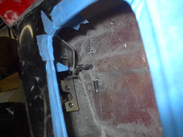

On the door handles I drilled the hole out way to big and then glassed in some pipe to act as a sleeve. I think you can make it out in this picture:

All real GT40 men do their own gaps. Welcome to the brotherhood! You will never look at a GT40 the same way again. The first thing I always look at first is the gaps.
Don't worry too much about fiberglass work. You can always just grind off the mistake and do it again
There is a huge amount of advice on doing what you are into right now. Hersh would be enough by himself but if you need any more help, just ask. I found ALL of the pitfalls when I did my car and ALL of the corrections here on this forum.
Gaps are a matter of 90% patience and 10% adding fiberglass. No matter how off they are, you can fix them. Go for a overall fit that gets as much of the gap length (total length of gaps on car) as close to a 3/16 - 1/4 width as possible. Then close the wide spots. I would recommend against cutting anything off unless it is of a last resort. PUT DOWN that saw big fella!
Get the doors as close as possible and set into the spider first then fit the front and lastly the rear clip and sills. Then it's back and forth between all three to achieve the most correct gap length idea. Don't get all fired up about measuring things. Nothing is the same side to side anyway.
Check out Tap Plastics for brochures on fiberglass products and other information. They really cater to the hobbyist. Drop by a store and have a look around.
You will need a orbital sander, flat boards for sanding filler, and a air-board sooner or later and rolls of 2" sand paper.
Add fiberglass to edges to close gaps in layers. Stand the piece on end with edge up. Lay 1/2- 3/4 " strips of matt soaked in resin on the edge and and let harden. You can do about 3 or 4 layers at a time this way. Then go back and add a few more until the gap is closed. Mask the piece with newspaper to prevent dripping resin from adding to the work. When you get it real close use a sander to trim off the excess.
Once the gap widths are done then add more matt where necessary to aline the panel surfaces. The resulting overlap at the edge is very strong. You can really get a lot done quickly this way and end up with a very strong edge.
A LIGHT coat of filler can be used to FINISH the edge. DO NOT use filler to close gaps, only to finish the surface, and only after all the fiberglass work is complete. I really like VET PANNEL ADHESIVE for filler. It is very strong. Much harder than body filler. It is also much more work to sand and really uses up sand paper but it is also much less likely to ding or chip off. This is really important around the edges.

Fran- I picked the car up on 1/10 (you of all people should remember this!) and you're looking at what roughly 2 wks has done (about 8 or 9 days of the car actually residing in the garage). The body work stuff is laborious and can be frustrating but once the doors are finally hung and trimmed, just cleaning up the gaps will be all that's left.
Through all this work however, I am leaning toward actually painting it now- especially if I'm doing the body work stuff. It'll be a learning experience for sure but everything on this project will. I am going to start obsessing about what colors now.
Bill - You might not have the body hung but you're well ahead of me on other issues. I'm sure you'll grow to love it as much as I am. Nice progress by the way.
Jonathan - Thanks for the tips. I have a feeling I am about to become an expert in fiberglassing.
Howard - that's Hersh in the picture and we're in the process of trimming down the dash so the A-pillars can slot in. That saw is getting little use in reality. Between Fran's assembly guide and Hersh's experience, we have arrived exactly where you indicated- as even as possible on the gaps all around the car, with the exception of the doors. I am working on getting them placed precisely and then will fill in the gaps. The back of the door is where it seems largest and will need the most attention. Like you said though, I am confident it will mostly be patience and persistance to acheive the desired results. Thanks for the pointers on the gap fill as well, Gorilla Hair was what Hersh recommended. Any thoughts on that?
I'll be back at it on Thurs, Fri and part of Sat. Time to see how patient I can be.

More fun with fiberglass this week.
Gauges in - check
Rear clip vent cut out - check
Taillights installed - check
Pedal box built up - check
Headlamp and driving light covers fit up - check
Headlamp holes cut out - check
Box with bunch of wires in it opened - check (what to do with it next???)
Filler caps located - check
Looking more and more like an actual car - priceless
Also included is additional random imagery, like more wiring mess and my home-made totally ergonomic front clip workstation. Enjoy, and as usual any suggestions appreciated.
Also FWIW, my handheld electric angle grinder did wonders on trimming the lamp covers. It was magical. I stenciled the headlamp openings with a piece of paper and cut it to very near net shape and finished the job with a hand file to trim it up. Work? Yeah, but I did both sides in about an hour and a half (including setup of that high tech egro fixturing).
The wiring and bodywork is what I have been dreading. So far so good, but credit a strong package off the shelf which has so far enabled me to be where I am already.
