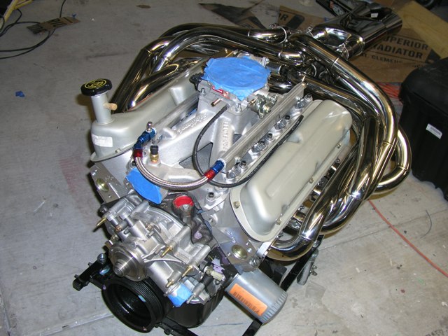

Guess what I got? Looks good, eh?
Cltuch disc, press plate and alu flywheel and bellhouse on the way from Dennis at Pantera Performance (303 660 9897). Should arrive this weekend. I could theoretically have the drivetrain mounted (but not permanently installed) this weekend!
The special shiny bits came with the deluxe kit and I must say they look fantastic on the motor!

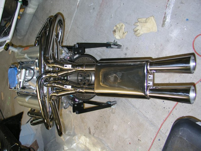

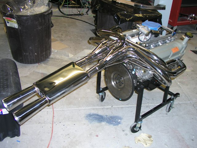

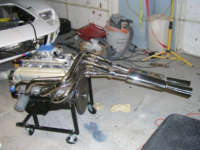

Are those RCR Headers? Could you get a closeup of the collectors?
I think I've already bugged Fran about this but forgot the answer - I'm wondering if the same headers for the ZF will work with the G50?

Pics to follow in the next couple days but the motor and trans are IN! Things went very smoothly with one exception: in cutting the clearance for the starter I cut right through the hard brake line on the opposite side of the chassis wall. Other than that, things went really smoothly. Started about 11 and finished around 430 (solo). Lots of setting it in, marking the wall, trimming the chassis, and repeating but I think it's good.
The headers are the RCR ones. I don't know if my set will clear the G50 but I am quite certain that Fran has them available. Best to chat with him directly.
I have the 6007-XB3 long block from FMS. I didn't know for certain it'd be short enough on the front but it looks like it'll fit pretty well actually. I don't yet have the pulley set figured out so I'll reserve my opinion for later but so far so good on the clearance front. Looks like it'll need a very small blister if at all (but like I said, wait til I am through with the pulleys).
Bolting things together was extremely easy though. I don't have a clutch in there yet. I needed all the pieces together to get through the cage build. Motor's in, headers are on, it's time to put it all back together and start bending tubes. Stay tuned for more pics.
Should be back on its feet by next week and will start looking really good soon.

I seem to recall that I answered you about the headers here
RCR Stainless Steel 180 Header system RCR40
and by email....maybe it did not get to you.
The ZF headers will NOT work with a G50 and visa versa.....

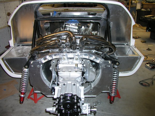

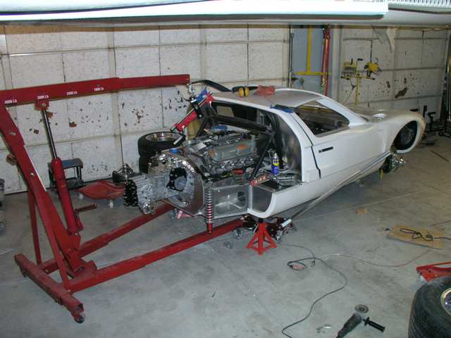

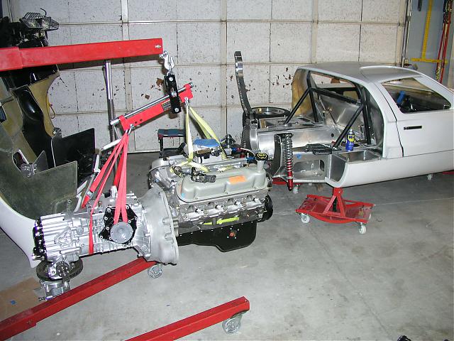

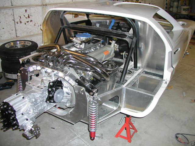

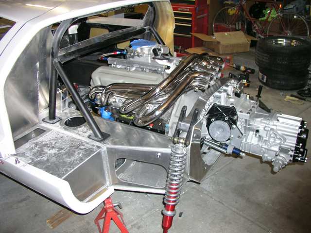

The pics...

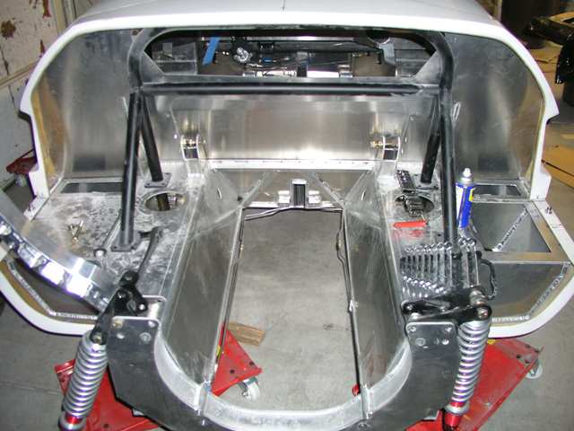

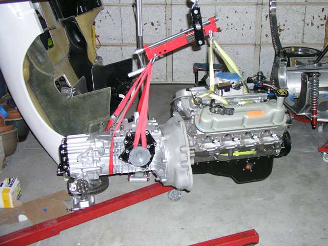

With the motor and trans connected and hanging there on the hoist, I had a flashback to the gazillion models I had built as a kid (and no-so-kid) with a drivetrain ready for install. This "kit" has the benefit of being much cooler and totally practical for later "display" as well.
It was a great feeling after the many trial fits and re-fits. I didn't want to cut too much from the chassis to make it fit and have a huge hole. I now need a starter to ensure it's all good.
Regardless, it looks great and once I get the suspension re-hung it'll be off to get a cage built.
Ah, progress!!!
