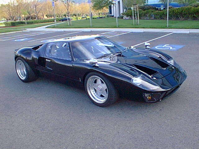

Here is another location,,If you like the air to hit you in the face. Putting it in the vent door is probably "cleaner" choice.

Why do cars in black always seem to have a "Bad Ass Don't F£$K With Me" look about them? [img]/ubbthreads/images/graemlins/grin.gif[/img]

I don't know, but it sure is true. That is one beautiful car. Those steamroller wheels and tires don't hurt, either--

Why THANK YOU Gents,,, [img]/ubbthreads/images/graemlins/laugh.gif[/img] You have made my day. [img]/ubbthreads/images/graemlins/grin.gif[/img]
