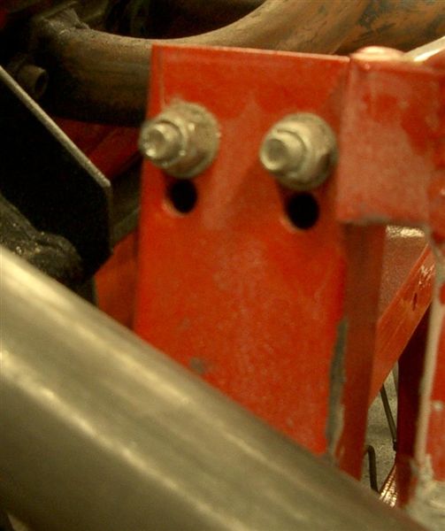

Hi Malcolm,
I wasn't happy with the rear of my GTD so along with Brian Magee we fabricated new radius rods, lower wishbones and top links to replicate as near as possible (subject to GTD chassis design constraints)the setup on the original Monocoques, canted the uprights back 7.5 degrees, and moved the top link inboard position up with full adjustment at all the joints, I think it is possible to get a good setup without going to parallel lower arms

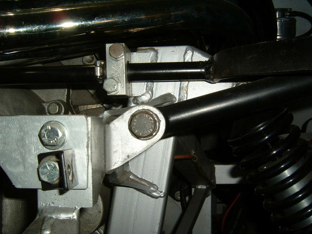

What great articles! I wish I had seen them before. Looks like we took really similar approaches to the problems.
The 3rd fig in the 1st article on suspensions is a really good illustration of the 'sweet spot' I was talking about earlier.
There is one small observation I would make about that 3rd figure. I order to compare apples to apples the static toe for the lower position measurement should have been reset to 0 at nominal ride height (by shimming the radius arm).
This would mean that the whole curve for the lower position should be shifted up so that it passes through the origin (suspension travel = 0).
If you do that you can see that you reduce roll steer to less than 1/3 of that from the upper position curve over the critical region from static to 2" compression.
His analysis of camber compensation is spot on. I came to very similar conclusions; ie that the upper inboard link must be raised. Have included a photo of the offset bracket I fabricated to raise this pickup point and reduce camber compensation. Used 5mm thick stainless to ensure strength was sufficient.

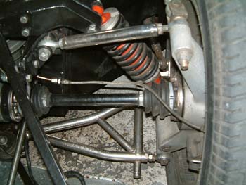

With reference to the choice of mounting holes for the radius arms, my car has the pickups in the top position. The suspension was apparentley assembled and fitted at GTD.
FWIW my car was very unstable in a straight line & would wander all over the place, however it would behave OK when cornering, ie with the suspension loaded up.
The straight line instability could have been caused by any number of mal-adjustments, but Trevors explanation would indicate the pickups were wrong, especially with the standard ride height of 6"....
