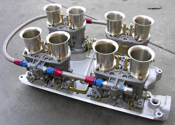

Guys I'm thinking about purchasing a 8 stack IDF set up from these guys
Ford V8 Webers 818 764-1901
Has anyone used these Guys before?
and for all the Weber experts out there please comment on this set up
and any advice greatly appreciated.

that seems a reasonable price for the IDF's to me, and I hear that IDF's are a littler easier to tune than IDA's. The set up should work well with a mild 302

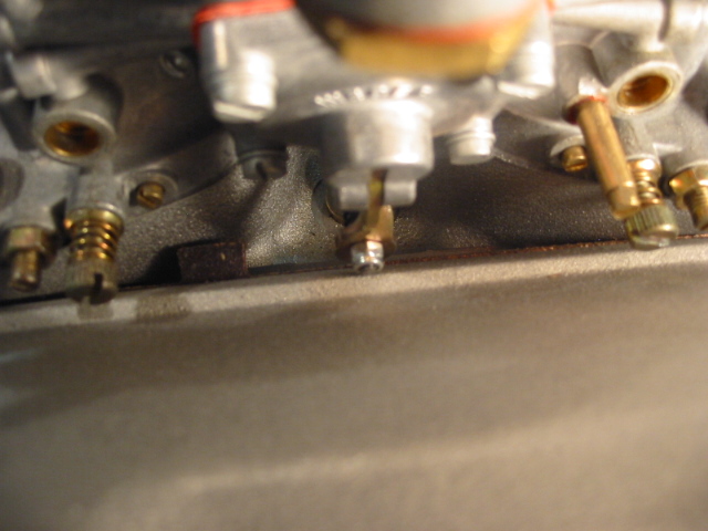

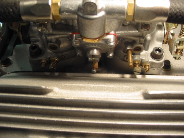

Here is a pic of the accelerator pumps of the IDFs hitting the Gureney-Weslake valve covers. Have not yet tackled this issue. I suspect may have to grind away a bit of aluminum to give it adequate clearance. If any one comes up with a better solution, let me know.
By the way, the "Ford Racing" covers that came with my engine did not seem to have this clearance problem.

Dave, Inglesse # NG1013 is a spacer for under the carb, $25ea X 8. .... A member on another website found them. I might have went that way if I had known about them at the time.
( Hold on for this ) I drilled corresponding holes in each valve cover. I pressed in 1/4 copper pipe end caps into the cover, (Think freeze plug.) When the shaft moves toward the cover, it goes into the relief area.
My way works fine and certinally would be an option for those with tight hood clearance. Otherwise the spacers would be the way to go.
Hopefully all of these methods discussed can help people decide what they want to use. Instead of eating up time figuring out how to make things work.
phenolic spacers will help by raising the throttle body enough to clear the covers and provide heat insulation for the webers. Of course it only works if you have enough room to close the hood or rear hatch.
