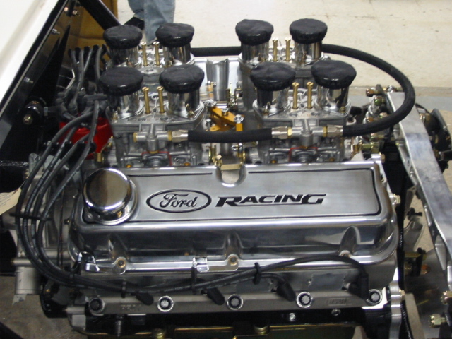

You noted: I wonder if steel rocker covers would be better as they are thinner walled than the alloy ones?? or does it travel that much that relief ports are a must??
With the steel "Ford Racing" style covers I had no clearance issues.
Chuck

Hey Chuck any chance of a Total height measurement from base of manifold to to top of ram tubes?
Oh and how do you Guys adjust your mixtures?? Looks like grip with your fingers and turn job??

Adjusting can be done with "finger/thumb" or the "Two index finger method." Either way, theres not really any problem doing it.
I use medical clamp thingy's to get at the acc pump nut.
Don't waste your money on filter screens. They choke the carbs beyond adjustability.
Im working on a air box this winter I hope
Sorry about some of my crudeness in materials. I like to torture myself. I missed my calling as McGiver on TV. (You don't want to see my crankcase evac.)
