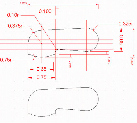

Dan was right it was a bit FAT, this is the thinner version which looks a little better.

Richard & Sandy,
First let me say I'm sorry for screwing up the whole thread by posting pictures that are the wrong size!
That last drawing looks good to me. Sandy, I think you nailed it. I was planning to just have the tabs made and have a friend of mine attach them to my dzuses (is that a word?) because I already installed them on the car. Maybe you could offer them both ways, just the tabs for the guys who want to retro fit and complete for the guys that don't have theirs installed yet. That way you have 2 markets!

Just downloaded the EMachine tool and imported the DXF for the fob, in .079 4130 steel, no plated finish,
Qty ~100 (+/- 5 as they do it) came out to $185.22 Shipped
that is with a 20 day lead time. Not sure how 100 cost $4 unless additional finish work was done or rapid proto time was requested.
The E-Machine tools is a bit primitive, but it works well with this simple drawing. I'm sure I'll be using it for other stuff (Driving light trim...).
For those that are interested take a look at the drawings, and see if the last image posted will work. Then we can go either Richard's pal or Emachine with out too much trouble.
Are 4 concidered a set or is it 6?
Thanks all for feedback!

Here are the measurements taken from an original Mk I. (I didn't adjust the shape of Sandy's drawing)
To me, the vertical edge, and the top edge look to be close to 90degrees.
