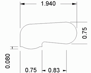

This is a rough draw of one of them that I came up with based on some dimensions from the DFCI site. This is probabally way off but here it is any-a-ways. I need this at least for getting some quotes The info I used was this
Head size 0.75", Slot Width 0.081", the rest is just a guess.
Kind comments?
Sandy

Here is a mock of Sandy's drawing.
Here is Sandy's drawing with about 1/8" off of the length and height.
Personally, I like the smaller version better. but I think Sandy's profile looks great. My slot is only .70. Sandy's drawing calls for .81 which would be a bit thick for my existing dzus, but I could always file it a little bit. Maybe .81 is needed for strength. A friend of mine strongly suggested that they be made from chrome moly for strength. I'm in no way an expert on that, so others might chime in here.

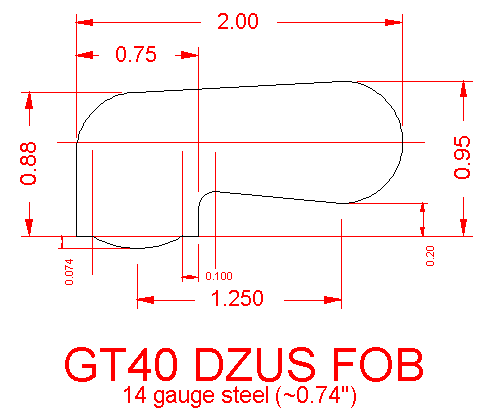

I modified the drawing a hair to potentiall make it a bit more universal and easier to make if you want to do one by hand. I rounded up the drawing units slightly and extended the height a bit incase it was too close to the hood line, see if too tall now (Dan if you can...)
I was thinking of using 14Gauge, which is about .074" not sure if Chrome Molly (4130) sheet is needed. If not would be about 1/3 the price for materials I'm guessing. (Comments!) I think some of the DZUS tools are alum so not sure if needed.
Here is the revised version

I think they are too short and would be a funny shape since they look smaller. I was just going to use them, but then got wound up on this thread. Something to do until the car gets here in any case, and if it helps others then everyone wins :)
