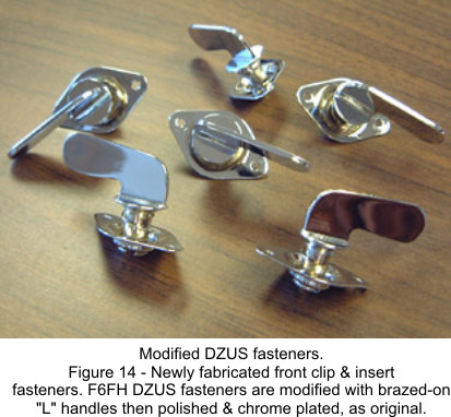

Are these what you are refering to? It appears that they used a standard set of dzus and braised on the 'L' handle, probably easier and faster to remove on the race track than reaching for a dime in the pocket to unlock...
Chris

Chris, Who makes the ones you posted? They look perfect.

These look to be a custom job, specially made for the GT40's. See www.racingicons.com, awesome site full of excellent photo references and text - and if you use Mozilla Firefox as your web browser (as you should be, Microsoft junk indeed [img]/ubbthreads/images/graemlins/smile.gif[/img]) you can right click and save the images.
Lynn - I concure with Dan, cannot find the 'L' shaped fasteners shown above - either that or I'm not looking where I should be...

My original thought was to cut out the tabs and have a friend of mine weld/braze the tabs to the dzus fasteners supplied by RF, and then have them plated, but it would be nice to find them premade.

I have made those from original Dzus fasteners for an original car. They are not hard to do for someone that is familiar with silver soldering. The joint if done correctly is practically invisible except for the slight yellow/gold color. I would think you could find someone near you that could duplicate those easily. The silver solder and flux are readily available at any welding supply, and although the silver solder is rather pricey (about $60.00/ounce) it will go a long way if used correctly. The flux is called Stay Silv, a white water based paste that is relatively inexpensive for a rather large container. Also there is a flux borne silver solder that works quite well, and requires only the pasting of the parts and heat. The trick is the heat, but with those small parts a plumbers torch will work quite well.
