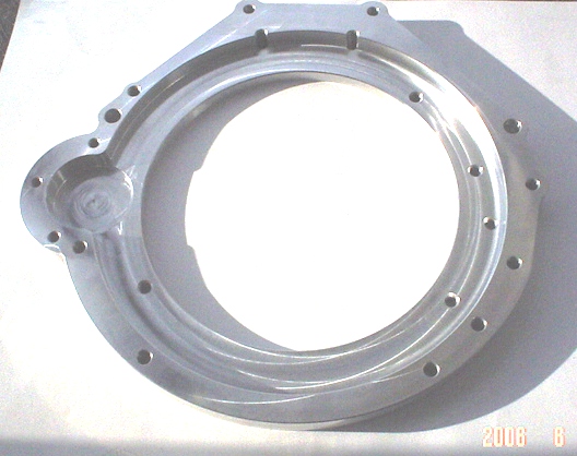

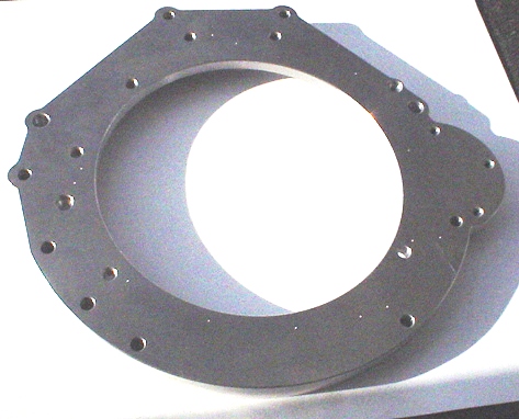

"Some" progress --Ford mod. 01E /AO2
Name:	F mod to Audi O1E, AO2 adapter 002.jpg
ID:	14139  Click image for larger version
Name:	F mod to Audi O1E, AO2 adapter 001.jpg

Nice looking adapter. Do you have the flywheel worked out yet? Would you share dimensions and other particulars once completed?
