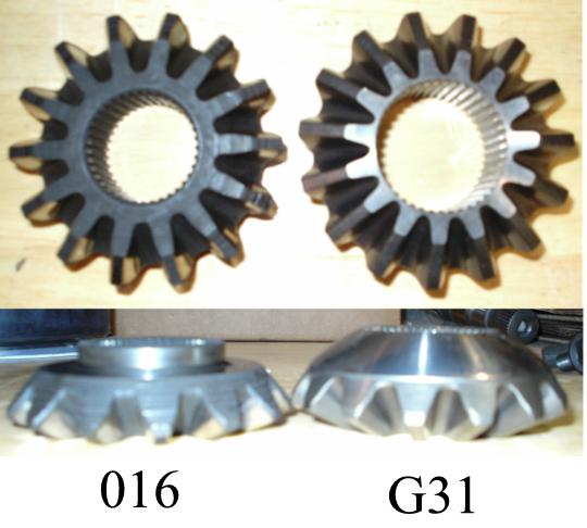

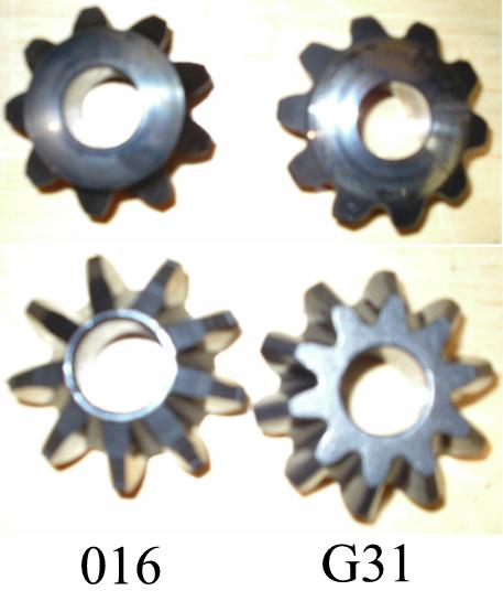

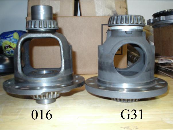

The pict's are a little deceiving. The two diff's are the same. The ring gears ade different. The G31/915/930 all use the same different diff. The ones in the pict's are open. I have a ZF lsd in my G31.

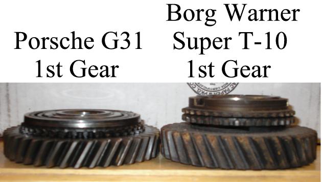

For those that don't know what a G31 is, it is a transaxle that was used in 1979-80 924's. It is based on the 915. The diff and gears are the same, the mainshaft and pinion bearings and retainer is the same, 3-5 gears are the same. The synchros for 1 & 2 are based on the 930, probably due to the long torque tube etween the engine and transaxle.
One thing to note is that the mainshaft, pinion bearings and bearing retainer between the 930/915/G31 are the same.
I have pictures from an article I wrote for another forum (944 Hybrid) comparing the 016 to the G31. I will post the pictures of the diff's tonight. (I don't have them on my work p/c) The diff, spider and side gears from the 915/930 is much more HD than the 016.
If you guys would like, I could post the article here. Since the G31 is based on the 915, most of it is relevant.
As a side note, a few guys on the 944 forum are running 400 rwhp with 944 turbo transaxles with good luck. But they do not do hole shots. They onlt use full throttle after the car is moving.
Since my car is powered by a Chevy 302 that is based on the old Z28's, I chose the G31 because I believe it is far stronger than the 016.

Here are the pict's. I addrd one additional of a Borg Warner Super T-10 1st gear vs G31 1st gear. The G31/915 first gear is 5/8"wide and the T-10 is 3/4" wide.
