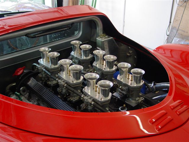

Here is a little Jag eye candy for you boys.....

Thanks Fran buggered if I can post pics which is just as well because I have so many of them I would drive you all crazy Regards

Ron at the moment this is a completely stock 1994 5.3 motor and it will stay that way until the car is sorted and registered the carbs are 40 IDE and are off another XJ13 built over here (all aluminium body)the owner wants about 400000AUD for it yes thats 400 K Regards

I dont know if the GT40 guys realise that the XJ13 is the same size as the 40 same wheelbase width height etc so the V12 makes for a very crowded vehicle

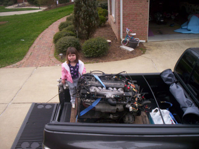

Well, I have a big Jag V12 in the back of my truck now, looks great! I'll have to post a picture here shortly. I'll be bundling it up for about a year before starting on the XJ13, but I hope then that the market for those will be developed and a few of them will be out there with builders.
R

This project is long term to lower cost so I'm searching for a gearbox and will get it if the time is right. This V12 was only $1200 with all running gear, everything intact, and the engine ran up until a month ago when it was pulled. So, it shouldn't need a rebuild. I plan to just pull all the electronic crap and accesories off and sell them probably getting the cost of the engine to around $600. Then I plan to pull the heads, deck them for a 10:1 compression and put a weber intake on top (got to check clearnaces on this issue). Don't plan to do anything else except for a nice exhaust system and I'm told it'll net about 375hp in this configuration with no stress on the motor - good for track work! The late model motors such as this one have forged internals so that is a bonus.

Ron you should take the heads off as soon as possible the longer it is left the harder it is to remove them, Jaguar V12 heads can really stick, I have seen guys use a block and tackle trying to remove these heads and all that happens is the car leaves the ground ,nearly always you will need a special removal plate

I didn't know that, I'll try and get the motor underessed in a month. What causes them to stick so bad? Ugh.
Any other tips or tricks you can thing of for these beasts? Damn thing is mighty big. Physically the largest motor I've ever messed with except for an aircraft radial. And despite being ally block and heads, it ain't light!!!!!

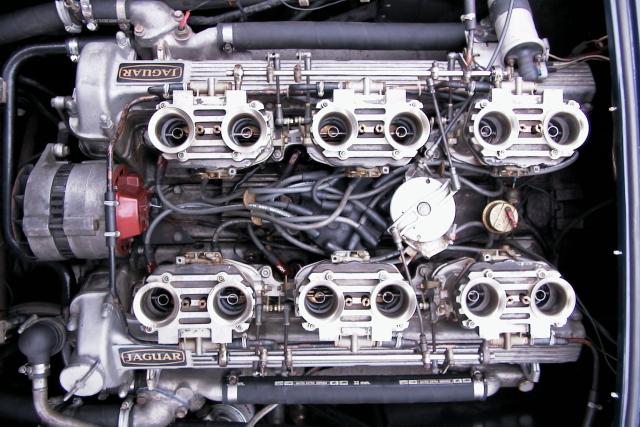

Early ?? V12 with Dellorto's ?? - either way - very nice. Was competing against us at Loton Park in a Dax Cobra - sounded superb!!

No, this one is a late model 1994 with fuel injection. If it does indeed have that compression ratio stock then it need not go any higher.
That one above looks fantastic!!!
