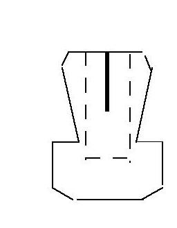

Well that's pretty much what I was worried about. I was going to make some dust caps for my car since it didn't come from the factory with any, and the o-rings that I could find were nitrile, rated to 250 degrees F, and Viton, rated to 400 degrees F. I know the calipers on my Eagle Talon ran at well over 300 degrees on the track (measured with Thermax strips), but that's the calipers, and I don't know how much of that heat would transfer to where the o-rings make contact, and I wasn't sure I could get the Viton ones in the size I would need. So what I had planned to do was make the "neck" of the caps, if you will, slightly oversize (probably tapered out from the cap) and then slot it so it could be compressed and make a nice friction fit.
Here's a poorly rendered, exaggerated-scale drawing of what I had in mind:
