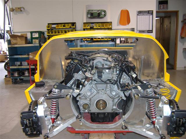

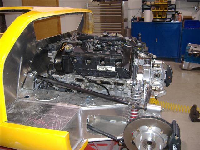

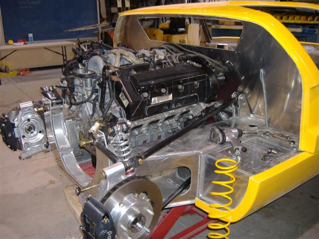

Just dropped this puppy in for a trial fit today...other than the expected header issue and a few things that the client will take care of....looks OK.....
Boy is it a big lump....

does look like the headers will be a challange. will i be able to remove the valve cover with the headers attached?
[ QUOTE ]
does look like the headers will be a challange. /quote]
Now there is an understatement ....... /ubbthreads/images/graemlins/beerchug.gif

Fran,
Based on those photos, it looks lke the terminator 4.6mod V8 (with the supercharger on top) could fit under the rear canopy. If a "cut out" was made in the firewall could the engine bay accommodate the pulleys up front? The terminator runs off an add-on pulley on the front of the damper. There are some aftermarket SC kits that would simply run off the damper and would not be as far forward. Essentially, there wouldn't be any pulleys forward of the alternator or AC pulley. Would this work?
Sorry no idea...we did two 4.6 installs and they were years ago....its not an engine we get a lot of call for obviously...check the date of the post with the pictures attached...2006...yikes.
Anything can be made to fit...it only takes time and money...or is it money and time??
Keep in mind that the GT40 rear bulkhead slopes and there is much less room moving directly upward from the crank pulley/damper than there is directly infront of the crank...
