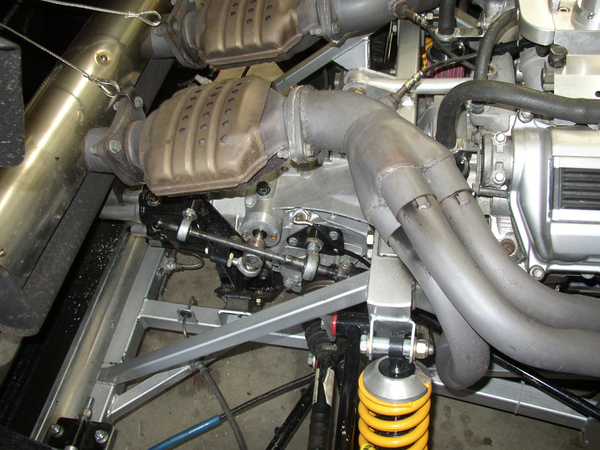

I have a few pics of a RF with a lexus engine here is one.
And another I have driven this car it goes well and is so tractable your granny could drive it.
Darrell
DRB #46
G50 LS1

Very nice work with those ITB's and the exhaust system. Someone's certainly handy with a MIG/TIG box and a Bridgeport. What sort of EMS is the owner using? Do you have any performance figures on the engine and/or the car?
John
The builder of the car has a engine reconditioning shop on the NSW central coast and is a toolmaker by trade he made the exhaust and throttle bodies himself. The ECU is a Microtec out of Sydney.
