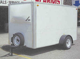

I want to make a smooth shape for the front of my trailer to increase the aero, something like what is shown on these pages:
NoseCone Pull Trailers
What would be the best way to make it? Create a solid surface out of wood and then cover that shape with fiberglass? If I did that what sort of fiberglass would I use, oz/thickness/etc, and how much resin would I need?

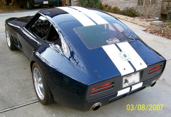

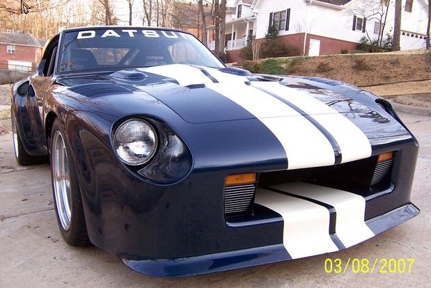

Ron, I'd just make this shape out of foam. Not sure, but I believe the pink foam sheets at Home Depot are resistant to resin whereas the blue is not (just hear-say). Personally, I've always used floral foam to make my unusual shapes, and if I used other foams that were not resistant to resin's effects, then I'd simply cover the foam with masking tape. What I liked about the floral (crispy) foam is that it can be sanded really easy (won't load up the paper) to the desired shape. If the sides are pretty flat, I use aluminum as the mold or buck, but then, why not just make it out of aluminum in the first place if that were the case?
I would think you're planning on a lot of driving to make this project financially worthwhile
Here is a 100% all fiberglass body (sans the C-pillar and roof) I home-built using this glass-on-foam technique.

Hey Terry. I remember the pictures of the Z when you first put them up but didn't remember you'd made them. Nice work!!!!!

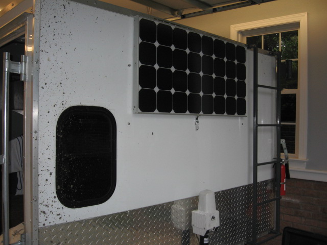

I'm trying to make this more aerodynamic:
Thought I'd put a rounded shape up there. Move the solar panel to the top and remove the ladder.
A truck piece might could work, but, it'd likely be too large. I need that window for sleeping in the box, else it'd feel like a coffin in there even with the door open.
