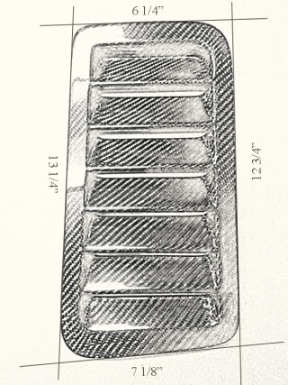

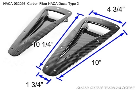

The 1st picture shows some mustang hood vents. Mocked some cardboard up and moved around back window.... too large looks goofy (picture). Settled on two naca ducts and they are in transit as I type (see pic).
Didn't want to hijack this thread and make it a engine bay heat thread but they're all related. My main focus is removal of hot air - not it's suppression.

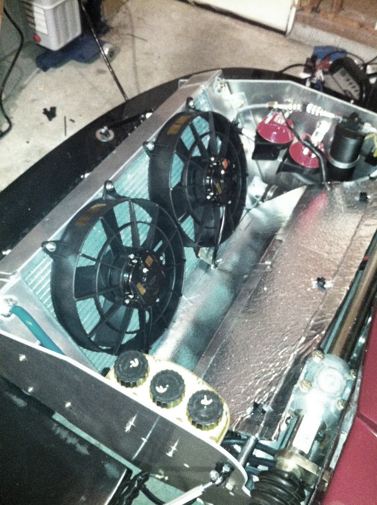

I'm going for thermal barriers and air movement. The NACA duct will be installed on the under-panel immediately under the front of the coolant tubes running down the middle of the interior. With some air being forced through the tunnel, front-to-back and out the engine compartment, plus ceramic coated SS coolant tubes, and a layer of closed cell foam insulation, I've found that the heat is not noticeably bad, but I don't have an enclosed cockpit either.
Mike, take a look at Howard's front clip pics. He extended the opening below the windshield and fabricated a pretty well sealed deflector. I have the race tail and in process of opening up the side scoops, as a few have done to aid in more airflow.
Also looking at rear window vent options. I did make a solid FRP part but have not decided to use it unless I find a workable vent solution. Please post the results with those NACA ducts.
How can you go wrong with NACA ducts! So cool, literately! :thumbsup:
