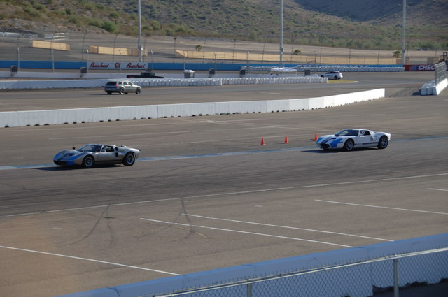

Alan, my Dad and I have a few track days on the GT-40. As delivered to us (second owner) the toe was out of whack and the front camber was almost 0 deg. We had the car realigned but I didn't get the specs...I'll see if the shop that did the work still has them.
For the track;
I felt the anti sway bars and suspension damping are too soft - rebound and compression. Especially the rear. I think we're going to revalve the rear dampers??
There is quite a bit of understeer, not such a bad thing for most people (myself included)
The chassis feels very rigid and stable.
The sidewall on the OE tires are really squishy. No surprise there.
We had too much fun driving the new GT and The SPF GT-40 back to back! Heres a pic...

Jeff, that is pretty neat pic. Too bad it wasn't a closer shot to see some detail on the cars. I'm assuming the GT40 is a Windsor based 427. How did it pull against the GT?
I'm sure the GT was easier to drive, but which car did you have more fun driving?

Well, when I drive the GT it is much faster than the GT-40 and when I drive the GT-40 it is much faster than the GT.
My Dad is a bit more conservative on the track than I am, so I honestly don't know which car accelerates faster. If I had to guess I would say the GT-40 is a bit quicker but all the noise could make it feel faster than it is!?
Given a choice of which car to track I'd choose the GT...my Dad, the GT-40. I think the GT-40 gives you more warning before loss of control than the GT that's probably due to the generous sidewall on the GT-40? My dad spun both cars (no damage), he commented about how quickly he was facing the wrong way on the track in the GT. No squeal from the tires, just instantly backwards. BTW, I happened to be looking in the side mirror when he spun. Thats one image I won't soon forget!
