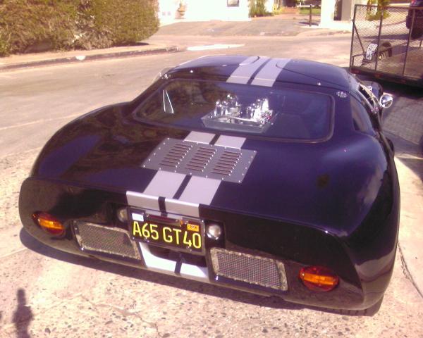

Hi, Larry, she looks very nice! I never particularly liked the Halibrand style wheels, but those polished ones look terrific against the black body work! A question, I don't see any hood-latch like devices, so what holds the rear body work in place? Are those little silver colored buttons on the roof part of the hold-down mechanism?

Thanks for the kind words. Regarding what holds down the body work: There are two fasteners, one on each side at the base, which clamp the clamshell to the chassis.

Oh my, if you're only relying on those two hartwell-style latches to hold the rear clamshell in place, beware. I've read about Hershal's rear end coming open at speed. Not pretty. I believe you'll find plenty on this forum regarding the necessity of adequate rear-latches.

Mitch D. advised me to get additional safety hold downs for my rear body work. I did some research and agree. So, I installed hood pins at the top of the clamshell and feel much better and I'm sure much safer.

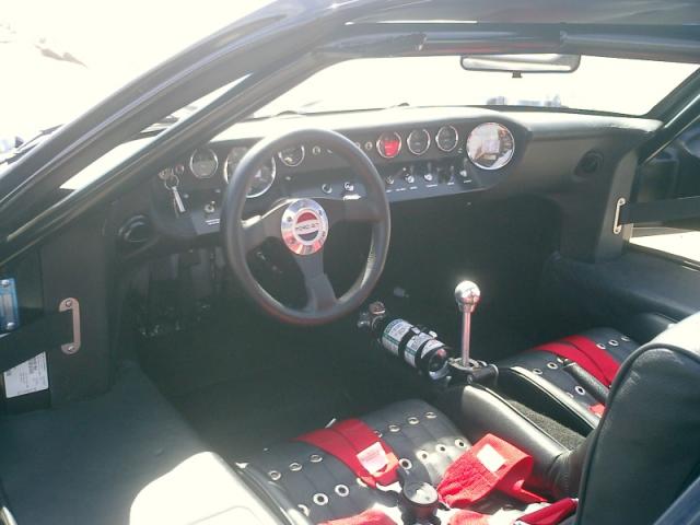

Your car looks exceptional and well sorted. I am curious as to the gear shift lever and mechanism(cable,hydraulic, rod). Could you elaborate and give some detailed pics?You need to be in the manufacturers column. Do you have any pricing that could be put on the forum? How about parts to non BEC owners? Where are you located? I am sure some of the guys, owners and prospective owners, would love to drop by, or get together. Give us the scoop. Don't hold back.... or out.

Thank you JCoop and Bill Musara for your kind messages about my BEC GT40, I'm very happy with my car. This past weekend I took it to a car show and was awarded the "Judges Choice" trophy and I hadn't even entered my car in the competition.
In response to Bill Musara's questions: The shifter is a cable set up and I must say that I very much like it. The application is very simple yet well-engineered, the shifting is smooth and precise, and it is easily adjusted. I'll see if I can get my kids to take and post some pictures (I'm not as computer savy as they are).

Bill Musara asked that I post some pictures of my cable shifter on my BEC GT40. It has taken a few days to get my kids to assist me, but here you go:
car guy is offline
Old 06-16-06, 12:53 PM   #13 (permalink)
car guy's Avatar
car guy
Join Date: Dec 2005
Location: San Diego, CA
GT40: Bailey Edwards
Posts: 104
Rep Power: 4 car guy is on a distinguished road
And a few more

Gearshift mechanism is off a 1990's Toyota Corolla front wheel drive. You can find 'em at just about any scrapyard this side...About the best positive action shift you can get IMO. You just need the cables custom made to fit your application.
