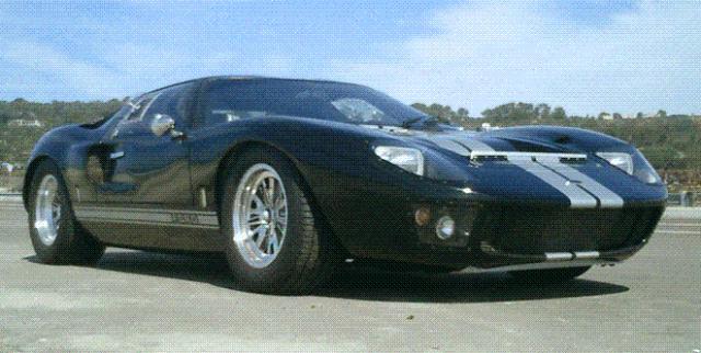

Pictures if my newly finished BEC GT40
I'm fairly new on the forum and have been busy working on finishing my BEC GT40. It has a '65 289 SBF engine which has been bored and stroked to 305 c.i. and produces 360 HP/TQ. Power is transmitted through a 6-speed 01E Getrag transaxle. Thought I'd put up a link to some pictures...hope this works. BEC GT40 pictures

Very nice Larry.How come I've not heard of BEC before? Looks like a nice kit.Are they Vintage wheels?
How about some engine pics?
BEC (Bailey Edwards Cars) is a South African builder of GT 40's and Ferrari P4's. They have successfully campaigned their GT40's in So. Africa's Vintage Racing circuit for the last 2 or 3 years and I am fortunate to have the only BEC GT40 in North America. By default, I guess I am their North American Representative. They come in various forms of completion from kit form, to rolling chassis, to turn-key minus, to complete drive-away cars for delivery in So. Africa.
BEC uses a space frame clad in aluminum...mine has a full roll-cage. The front suspension is fully independent double-wishbone type. The rear is also independent double-trailing arm with traverse top link and lower wishbone. The suspension has Bilstein adjustable coil over shocks with anti-roll bar at the front and rear. Suspension mounting is fully adjustable with rose joints. Brakes are 4-pot AP Racing calipers with 12” vented disks. The wheels are Halibrand-style Trigo polished alloys with center knock-off and pin drives. The leather interior has original Smiths gauges, 13-inch 3 spoke steering wheel, 4-point racing harnesses, air conditioning as well as original floor mounted Tilton pedals.

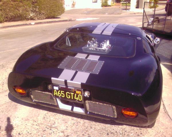

Hi, Larry, she looks very nice! I never particularly liked the Halibrand style wheels, but those polished ones look terrific against the black body work! A question, I don't see any hood-latch like devices, so what holds the rear body work in place? Are those little silver colored buttons on the roof part of the hold-down mechanism?
Mitch D
Thanks for the kind words. Regarding what holds down the body work: There are two fasteners, one on each side at the base, which clamp the clamshell to the chassis.
Oh my, if you're only relying on those two hartwell-style latches to hold the rear clamshell in place, beware. I've read about Hershal's rear end coming open at speed. Not pretty. I believe you'll find plenty on this forum regarding the necessity of adequate rear-latches.
Mitch D
Mitch D. advised me to get additional safety hold downs for my rear body work. I did some research and agree. So, I installed hood pins at the top of the clamshell and feel much better and I'm sure much safer.

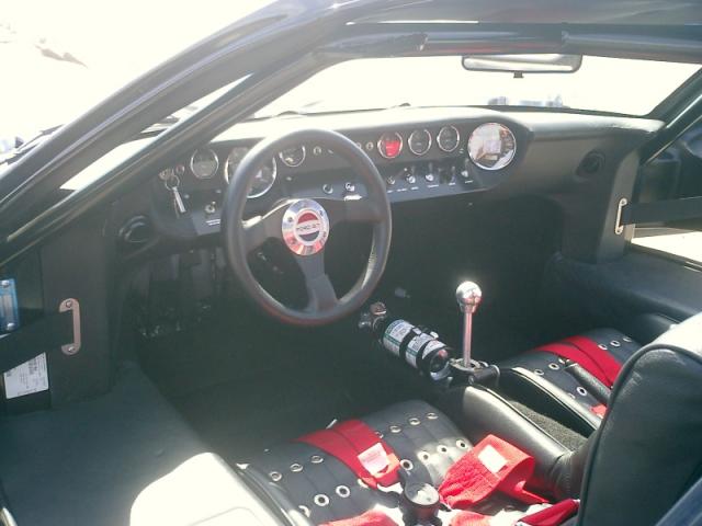

Your car looks exceptional and well sorted. I am curious as to the gear shift lever and mechanism(cable,hydraulic, rod). Could you elaborate and give some detailed pics?You need to be in the manufacturers column. Do you have any pricing that could be put on the forum? How about parts to non BEC owners? Where are you located? I am sure some of the guys, owners and prospective owners, would love to drop by, or get together. Give us the scoop. Don't hold back.... or out.
Thank you JCoop and Bill Musara for your kind messages about my BEC GT40, I'm very happy with my car. This past weekend I took it to a car show and was awarded the "Judges Choice" trophy and I hadn't even entered my car in the competition.
In response to Bill Musara's questions: The shifter is a cable set up and I must say that I very much like it. The application is very simple yet well-engineered, the shifting is smooth and precise, and it is easily adjusted. I'll see if I can get my kids to take and post some pictures (I'm not as computer savy as they are).
I am located in beautiful San Diego, California and I would welcome any and all visitors to come see my car and talk about GT40's. Bailey Edwards Cars has their own website (www.baileyedwardscars.co.za), but as you will see, it has limited information. It is obvious that they are more interested in racing and building high quality cars than in building web sites. And to answer your other question, yes you can buy individual components from BEC as well as cars in various stages of completion. As for pricing, contact me and we'll get you a quote on whatever interests you.
Bill Musara asked that I post some pictures of my cable shifter on my BEC GT40. It has taken a few days to get my kids to assist me, but here you go:

Gearshift mechanism is off a 1990's Toyota Corolla front wheel drive. You can find 'em at just about any scrapyard this side...About the best positive action shift you can get IMO. You just need the cables custom made to fit your application.
