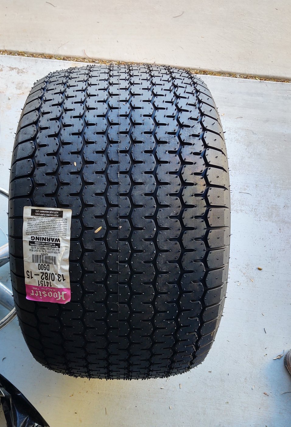

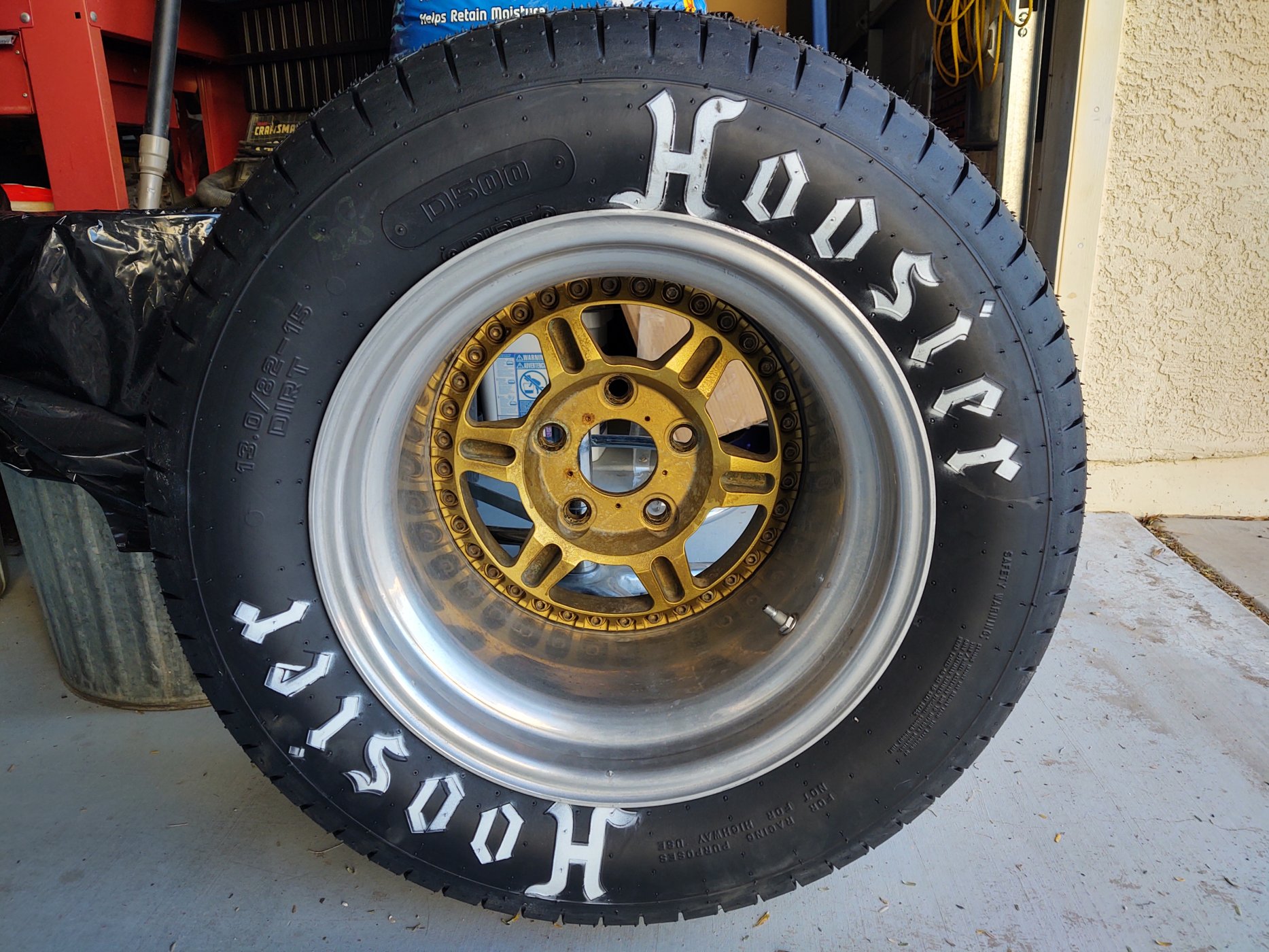

Here are pictures of a 15" Hoosier tire on a Jongbloed modular wheel. They are not slicks; their tread pattern reminds me of the old Dunlop Green Spots.
They look great, it's a very hard compound, but it appears Hoosier is overstocked and currently having a blowout sale for $60 a tire on that size!
Neil
Yes, that's what I paid ... and only $15 for shipping - 2 tires! A real bargain.

I looked at the Hoosier tire and it has durometer of 62 which is akin to a regular street tire like a Toyo RA1, I'd have no hesitation in using them on the street given many of the recommendations in the discussion are pure race tires. I could get a set of front and wider rear for $325 delivered, that is an amazing deal considering I just shelled out $2300 for set of Avons in similar sizes.
