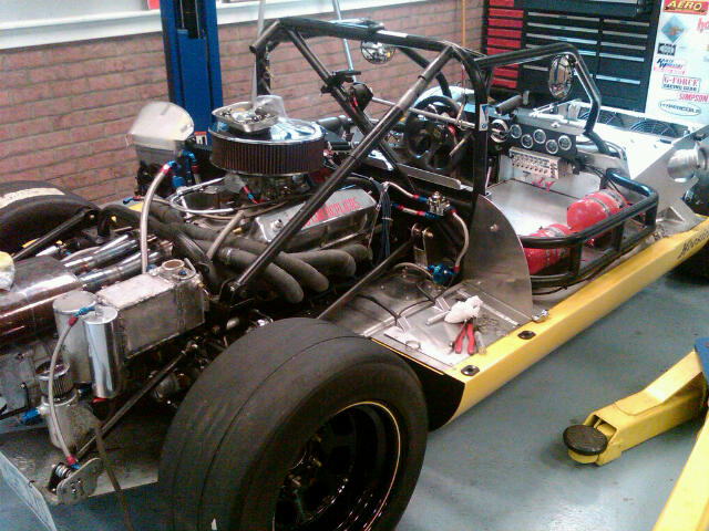

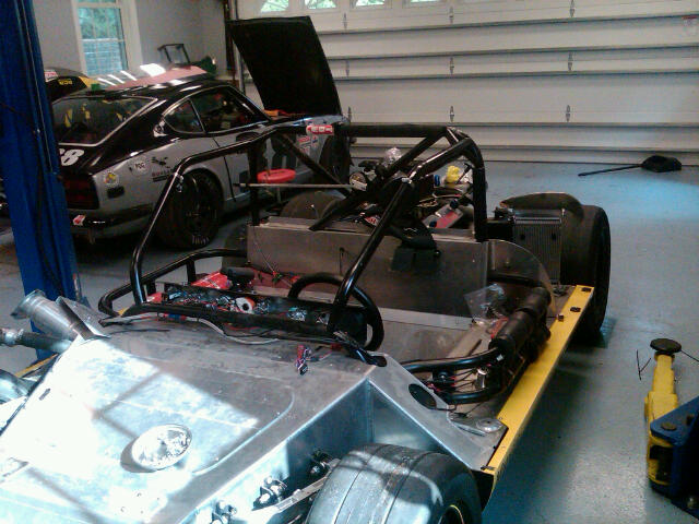

As mentioned, we're on for the 2010 Ultimate Track Car Challenge at VIR sponsored by Grassroots Motorsports and NASA. We've been working in the garage prepping the car for the event and have it going back together now, although still naked and apart.
We'll be heading up to VIR next Thursday and the event takes place on Friday. Last year there were some really cool cars running that were spectacularly fast - the most memorable was a MOPAR 440 BB that was only a second or two off the Daytona Prototype there, around a 1:50 time on the full course. Should be back this year. Spectators are welcome, I think, for $10 admission.
I'm happy to report that we're getting close to being prepped for the UTTC this coming Friday. I performed an around the neighborhood test this afternoon and the modifications all seemed to take. We'd enlarged the header tank substantially, re-routed oil cooling, put an electric fan on the oil cooler, wrapped the headers, put on higher rate springs, and made some adjustments to the instruments, screen, ignition, catch tanks, and coolant bleeds.
