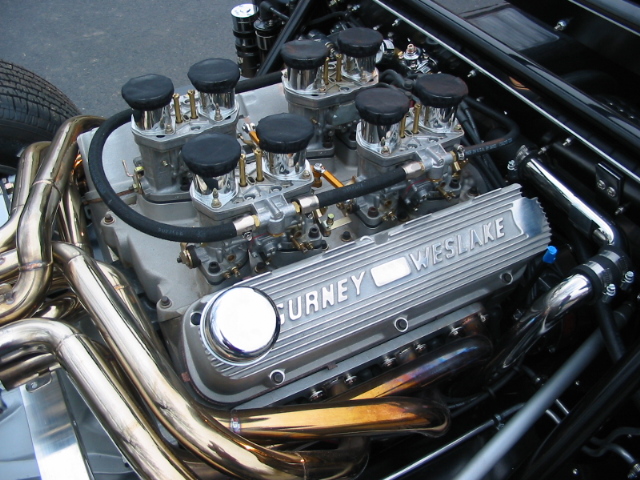

We need some advice and suggestions. Just now getting the engine going since the rest of the GT is done and we are having some issues.
<B><U>Engine specs:<?xml:namespace prefix = o ns = "urn:schemas-microsoft-com
P><P><FONT size=3><FONT face=
302 ci.
Compression 9.37 : 1
Chamber volume: 60 cc
Comp cam / hydraulic rollers
Dart Pro head
Intake valves: 1.94
Exhaust valves: 1.60
<o:p></o:p>
Carb:
Weber IDF x 4. Venturi was changed from 36 to 32 by T and L while dyno testing to get appropriate performance. Idle jets are #60. The carbs are balanced per the air flow meter. Idle mixture screws out about 1 to 1 ¼ turn each. Idle stop screw about 1 turn past initial contact. We have tried the 'best lean' technique for setting the mixture screws, but it is really hard to tell whether it is correct or not.
<o:p></o:p>
The engine starts right up and idles nicely around 800 to 900 RPM. When cold it spits a bit. Once warmed the spiting at idle is minimal. When the engine is driven or reved, however, it spits and backfires through the RPM range.
<o:p></o:p>
The engine does not seem to have much power, but given the spitting and backfiring and vibrations it is hard to tell.
<o:p></o:p>
The spitting does not seem to be from any particular cylinder. It is random.
<o:p></o:p>
Now here is the real problem. There is a significant vibration, worst between 2500 and 3000 RPM. It occurs when the car is reved whether parked or while driven. The vibration is much worse than I would expect even for an engine bolted essentially directly to a monocoque chassis.<o:p></o:p>
<o:p></o:p>
Some ideas:
<o:p></o:p>
1. Timing? Perhaps it is naïve of me to assume that a dyno tested engine was timed correctly. (Not sure what the optimum timing would be for a 302).
<o:p></o:p>
2. Balance? The engine is 28 ounce. Surely T and L did not use the wrong harmonic balancer / damper. But perhaps the flywheel from Kennedy Engineering was not 28 ounces? It had no markings on it or any written documentation when received but I was assured in a follow up phone call that it was 28 ounces.
<o:p></o:p>
3. Valve issues? Rocker arms? The rocker arms that came with the engine have been known to have some issues, and I have a replacement set waiting ready to install.
<o:p></o:p>
4. Carb adjustment? The car does not seem to have the dreaded ‘dead spot’ in the transition zone around 2500 – 3000, but given the vibrations we have not pushed it hard so can’t really say for sure. Can’t quite see how the carbs would be responsible for the vibrations.
<o:p></o:p>
This is new territory for me and any suggestions on where we should start would be welcomed.

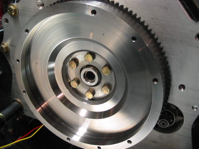

The flywheel came from Kennedy Engineering and was not balanced with the engine.
I am trying to confirm with T and L that it is in fact a 28 ounce balance (as I was told originally). I am also trying to confirm what damper was used to see if that might be an issue. Hope to get responses shortly. Are dampers typically marked with the balance weight? Getting to ours is a bit of a challenge since it is burried deep but if they are typically marked that would be a good place to start.

Some of the dampners have add on weights and are neutral balance if not installed. It allows them to fit either engine. You will have a hard time telling without pulling the piece. It may have been left off by accident, or the wrong weight was put on. Just a thought. In any case you need to pull it to make sure. Your flywhell should have some holes drilled in one section it to allow for the "imbalance". Again, you will have to pull to know for sure. Kennedy sent me the wrong wheel with my order. Mine is internally balanced and they sent me one of the "unbalanced" wheels. It happens.
I would just have to think that if it were a balance problem it would not smooth out at higher RPM. If the wrong balancer is on, again I would think the engine would shake very badly at all RPM, although I suppose if the flywheel is very slightly out of balance or some other component is then you might get those symptoms as harmonics come into play. I vote for unbalanced carbs. With webers ,if one carb is not feeding well at certain RPMS, you will get vibration
I would plump for a balance issue. More to the point a couple imbalance. Heavy points opposite each other at opposite ends of the crank. This will run smoothly at some speeds but vibrate badly at certain speeds. Your crank should be balanced fully assembled with bob weights on the rod journals, flywheel and clutch and balancer on. The "Harmonic" balancer must match your set up. Your vibration at 2500-3000 will be the major harmonic and it will smooth out and come back at 5000-6000, it is unlikley you will notice the 1250 harmonic as it will not be large enough.

Good suggestions. Before we take apart the tranny or buy a new MSD box thought we would explore other issues this afternoon. Like the carbs. Here is what we found.
The main venturis are 32 mm. Per the spec sheet the first pass was with the 36 mm venturis.
The idle jet is 60. The air jet is 175. The main jet is 135.
We have the idle pretty well set. Once warmed up it does not pop and back fire while idling.
Around 2500 - 3000 it gets nasty. Lots of backfiring and a bit less popping, but still way too much. Backfires less above 4000.
We replaced the air jets. Our reasoning was they had more to do with the transition circuit in the 2500 RPM range where we are having all the issues. First went up to 180. It seemed to run better, a bit less poppoing and backfiring, but still too much. For a point of reference we then went the other way, to 170. It was worse, so we went back to the original setting of 175.
Before we do any more experimenting with the air and main jets, does anyone have any suggestions? We may try 185 on the air jets, since 180 was better than 175.

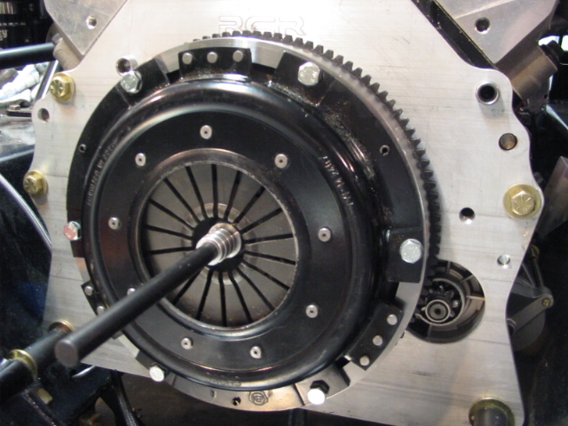

Flywheel dowels installed for the clutch/pressure plate?

3. Pics of the flywheel and clutch are attached.
