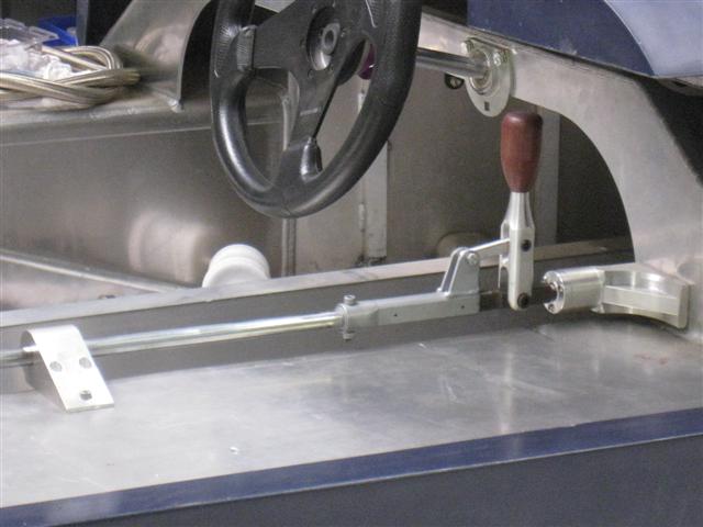

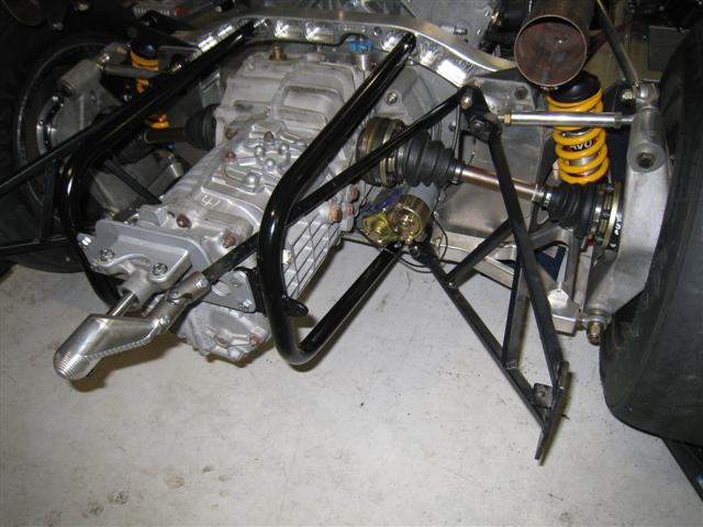

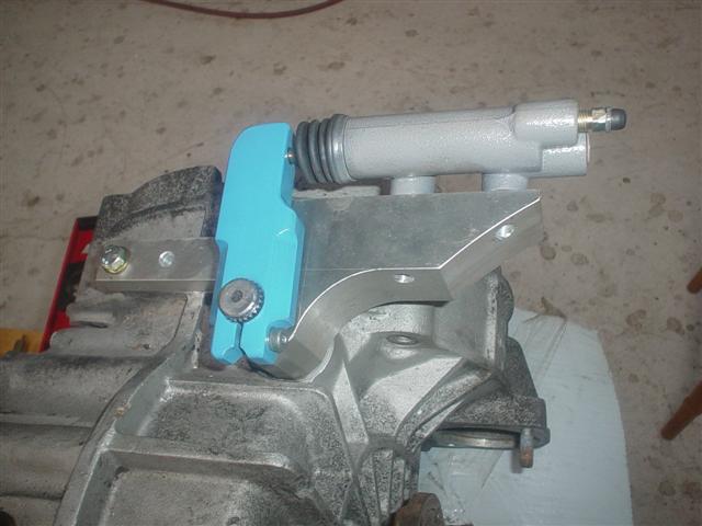

The 930 is simple! -- a single rod shifter is all that is required
