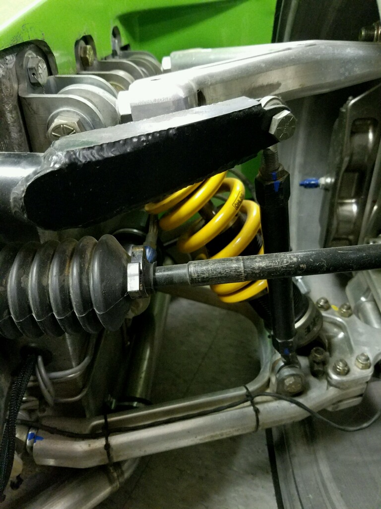

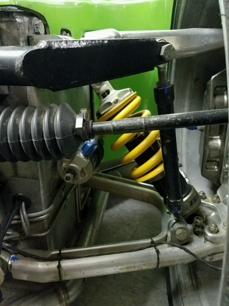

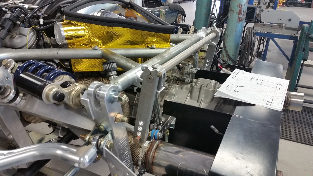

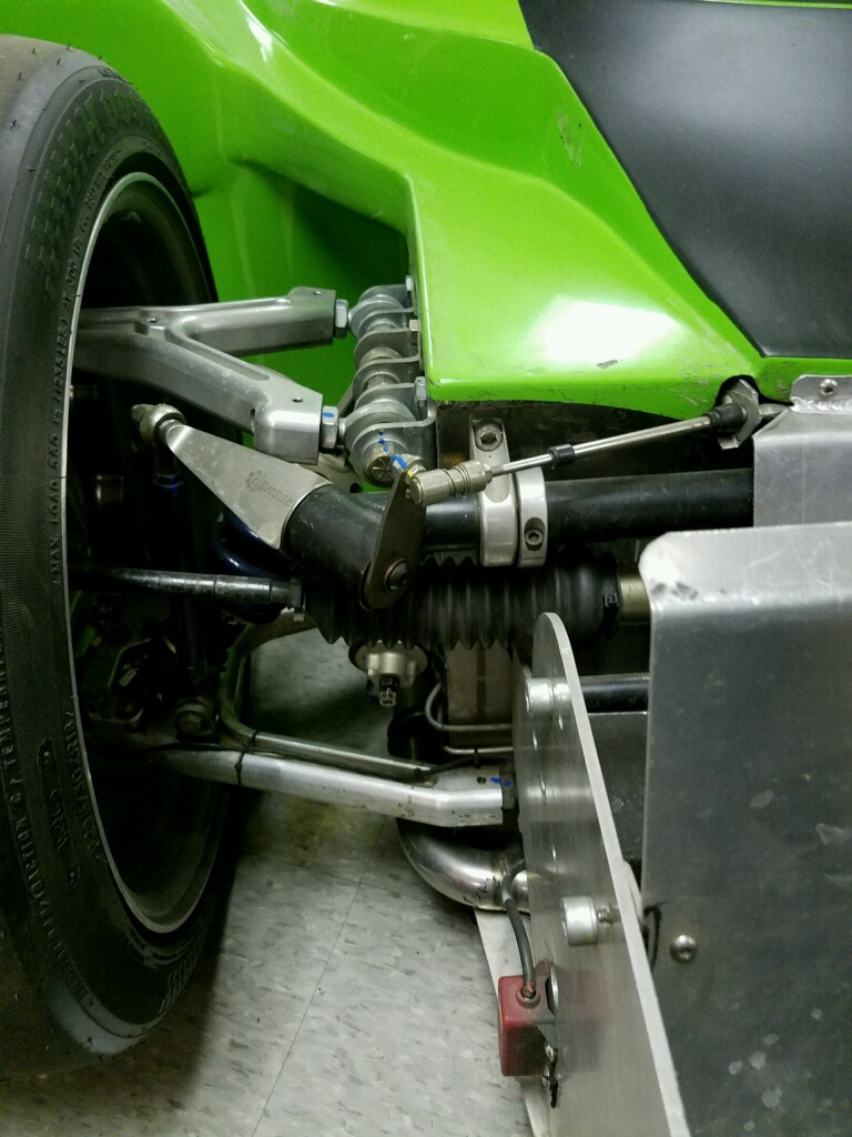

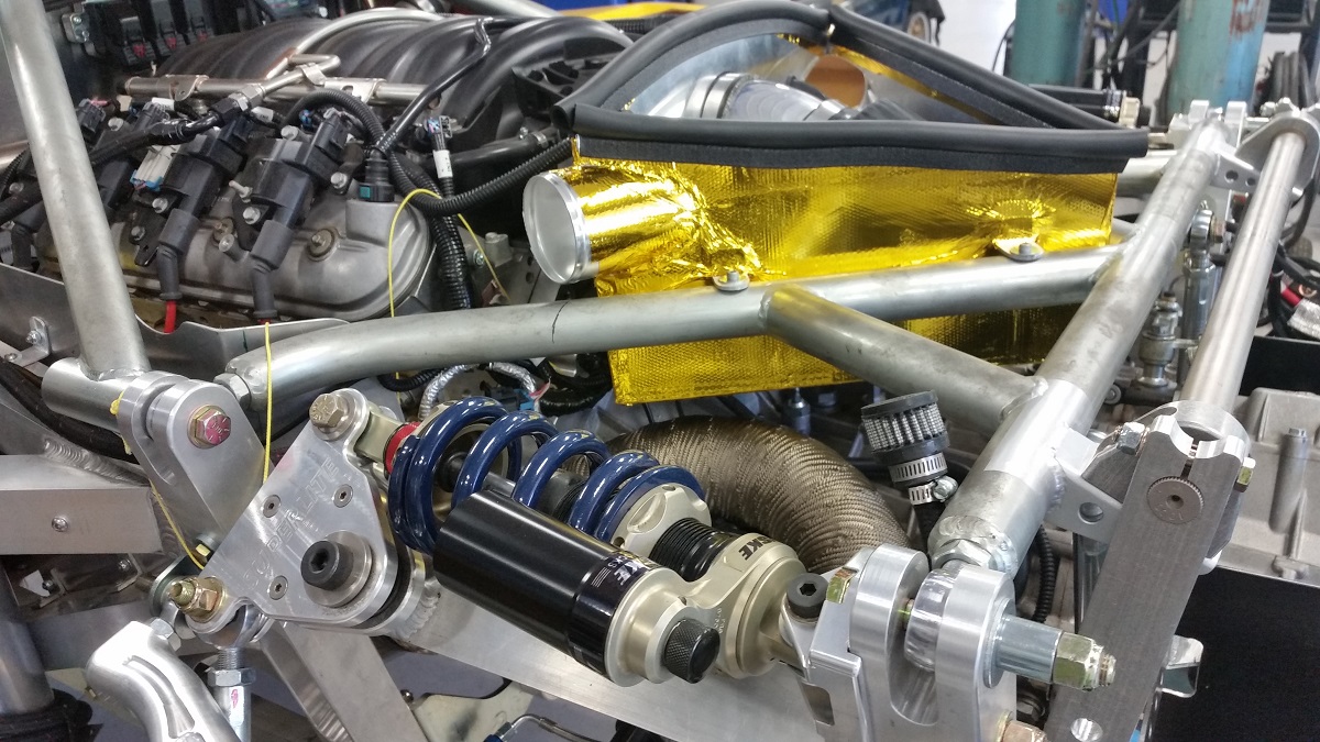

Here are some pictures of Ed's custom sway bars...

Scott

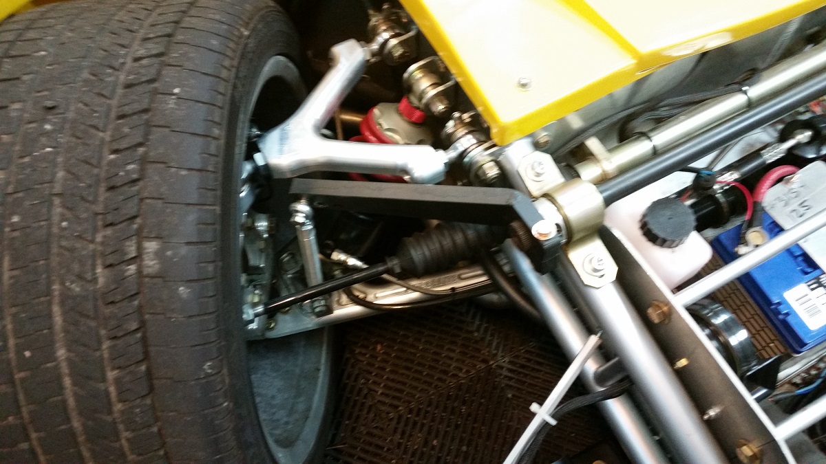

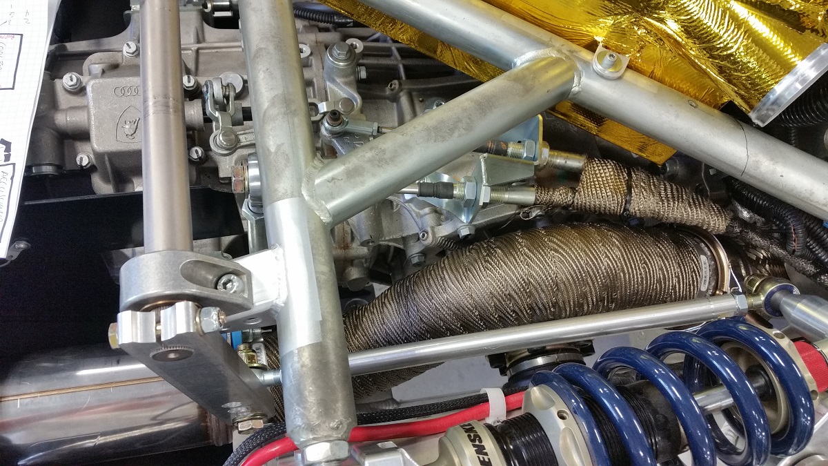

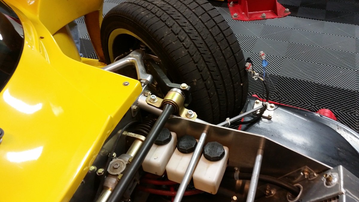

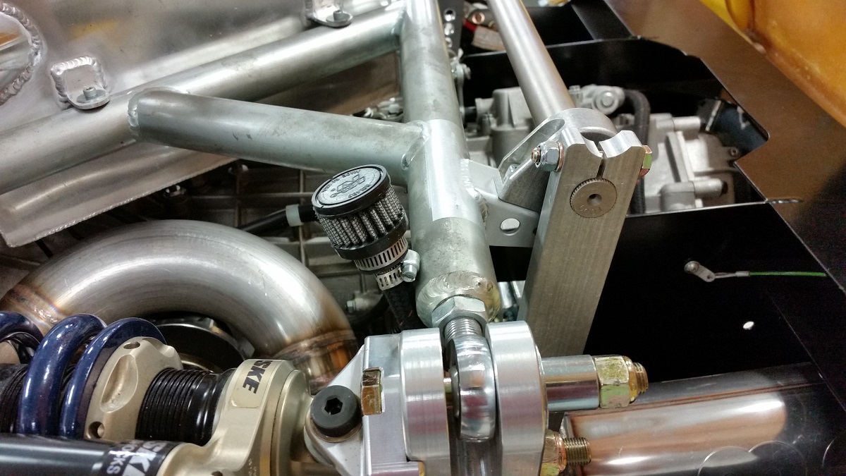

More pics from Ed...

I chose the SL sway bars because they appear well engineered and are cockpit adjustable. According to Fran, they take nearly 40 hours to fabricate. My plan is to connect them to linear actuators with integral position sensors. That will enable me to have a softer/firmer rocker switch as well as a couple of presets. Fran, it would be really helpful if you could provide the linear cable travel as well as required tension so I can start sorting out the linear actuators and control system.

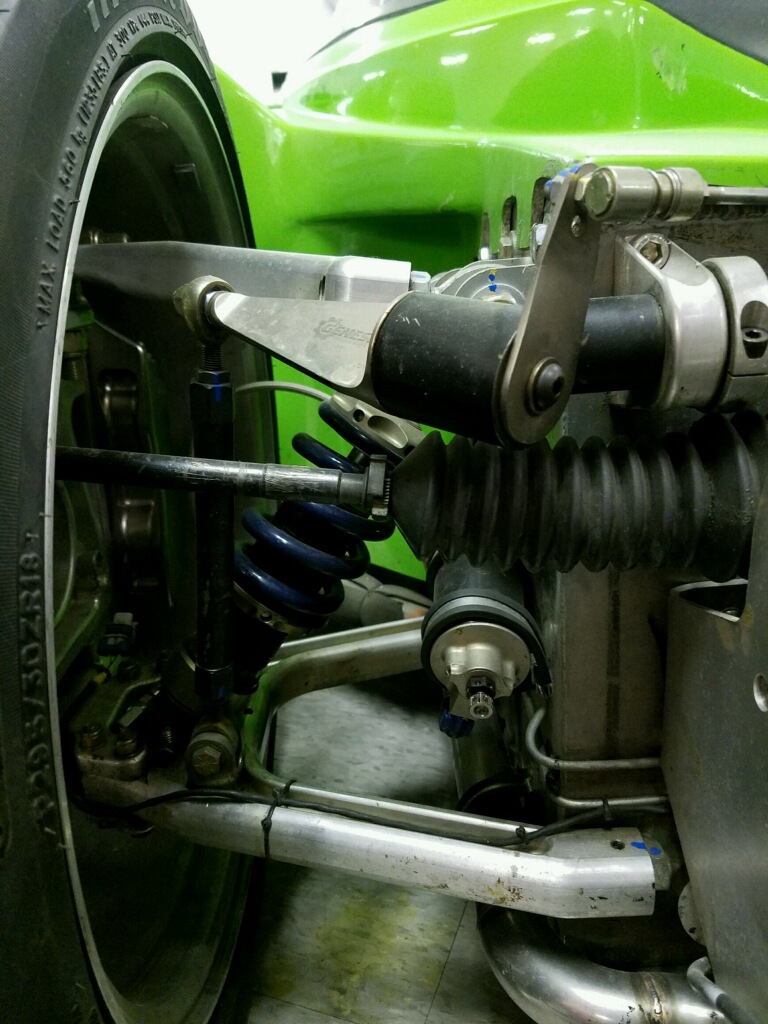

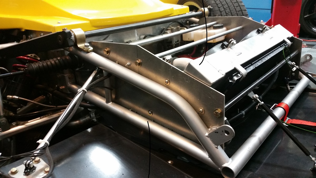

Below are some pictures of the front sway bars. They are way more sophisticated than any splined bar solution I could come up with:

I've just started looking for a fairly simple solution for semi-adjustable yet affordable bars, I feel the car needs them for anything more than slightly spirited driving on the road. Based on the photos above, I now see why it the car doesn't come with them and most don't both installing them. :/

Scot, I think you're confused with the "street" sway bars. They had fitment issues and were mounted under the chassis. I am aware of several builders who didn't install theirs. To my understanding, Superlite is working on redesigning them.
The "race" version is a different animal. If anyone has experience with them, I'd love to hear about it.
Guys i would to learn about these, does the flattish bar get twisted by the pushrod so that is either a horizontal flat bar that offers a preset amount of resistance that increases as the bar is turned to the vertical position, i have not seen a bar of this type before, are there any details out there that any one knows of that covers their design / calcs etc , fitting a linear actuator to a bar is something i am considering for my project.

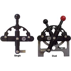

Lambo,
It's pretty cool that superlite offers them as an option... otherwise I wouldn't have known about them.Look at the pictures here:
cockpit adjustable sway bar - Bing images=
The adjustability is performed by pulling on the handles shown below (I assume the two handle version is for front and rear bars). Looks like 5 levels of adjustments with the handles having a max of 2x leverage. If a driver's going to be able to move them, then I can't imagine there is that much tension. In addition, those controls should give you a good idea of the max linear motion (not sure if all 5 positions are typically usable or not).
A linear actuator has the advantage of very fine grained settings and no need to put the levers in the cockpit if you're building a nice interior.

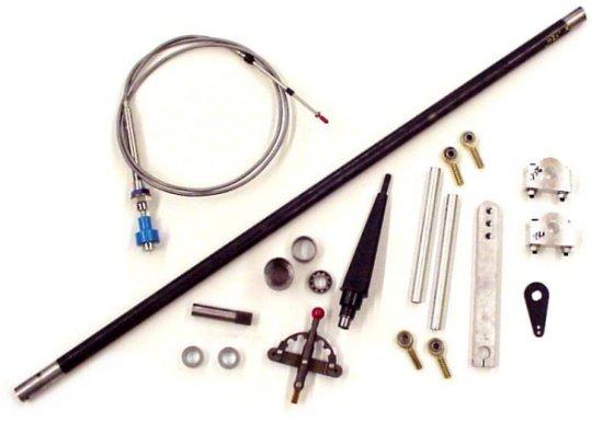

I also havn't seen this type of adjustment method. I chased down all the parts though and it appears the rotating half cone has a 180 degree adjustment range. Rotating the cone will put the leg of the cone either inside (stiffer I assume) to, or anywhere between, further out (softer). Leverage on bar stays the same, but you can lengthen and shorten the bar length effectively. Longer bar= easier to twist given everything else the same.
Pretty good solution to a rather complex problem.
