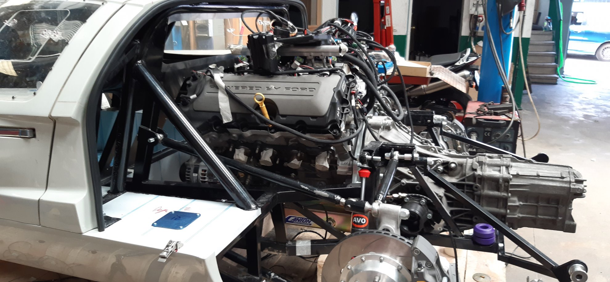

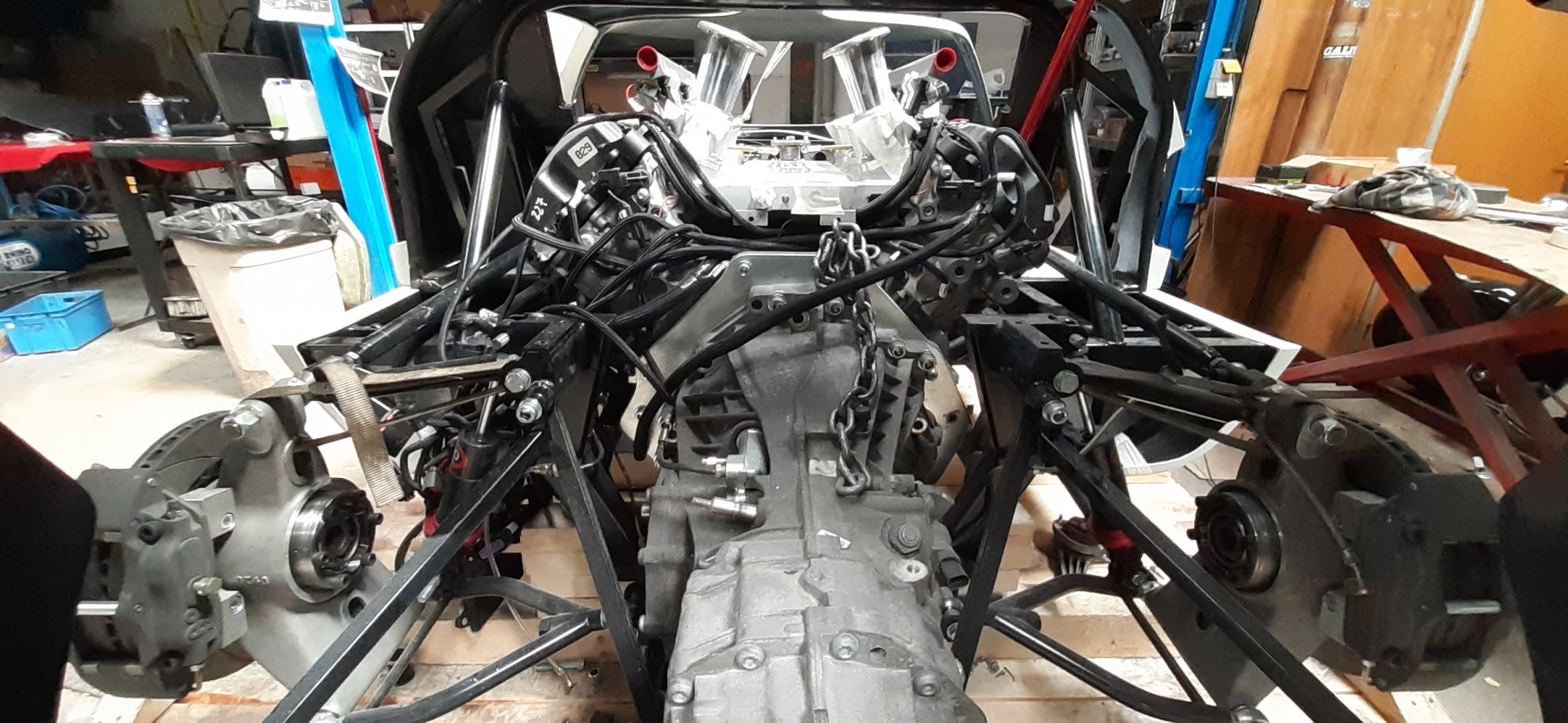

We want to put the engine and the gearbox as low as possible. He we do not do this to the left side of the chassis the engine and gearbox will be too high in our opinion.
Now we have a real low gear box and engine
Yes. You could do it only shaving the left side of the gearbox, but the coyote engine will sit high (maybe in a Windsor do not occur this)
I’m going to run a 351 so when the time comes we’ll find out. Guess there’s no harm in reducing the casing down. How did you do it, grinder?
Yes. With a grinder machine.
Just be carefull do not shave too much (it is just a cover plate but do not go too deep inside)

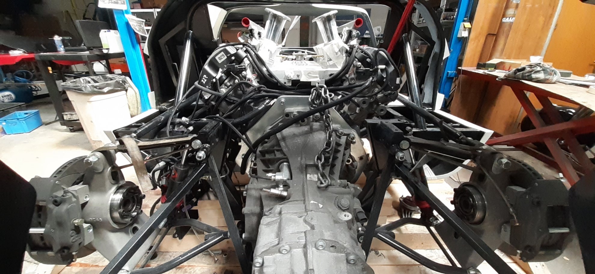

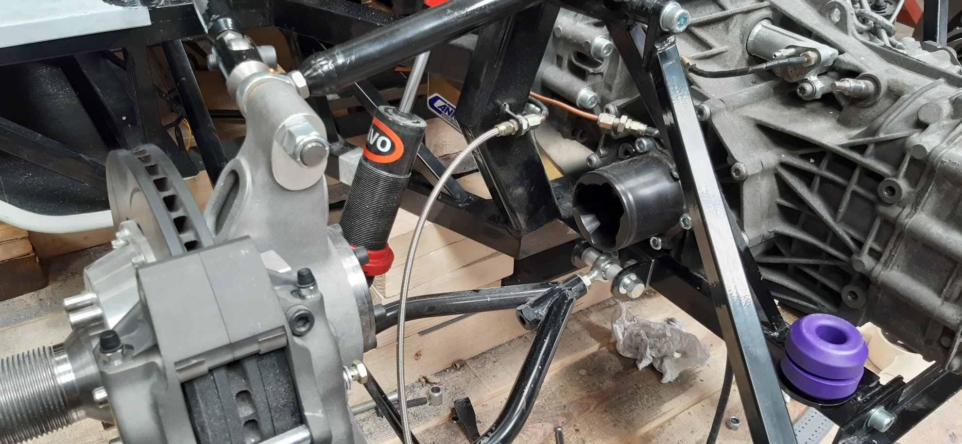

How did you run the clutch lines for the 01x gearbox. Did you run the driver or pass get sill. How did you plumb the line into the gearbox.
Hello Phil
I run the lines through the sill driver side to the pedal box.

At the back of the car where did you take the line in the engine back to the gearbox itself. Any pics you can send wound be a big help.

I found these pictures. I hope it helps.

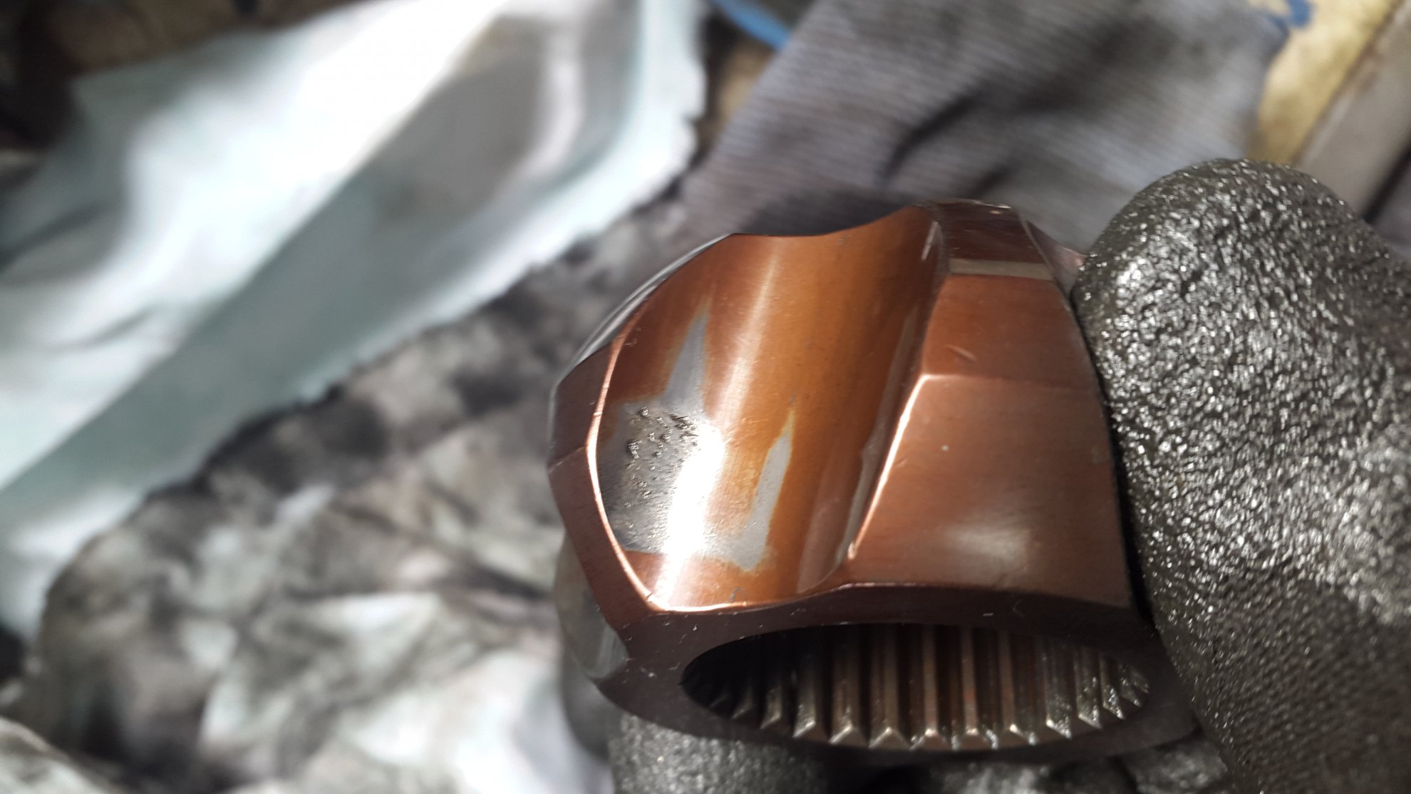

Hi Karel

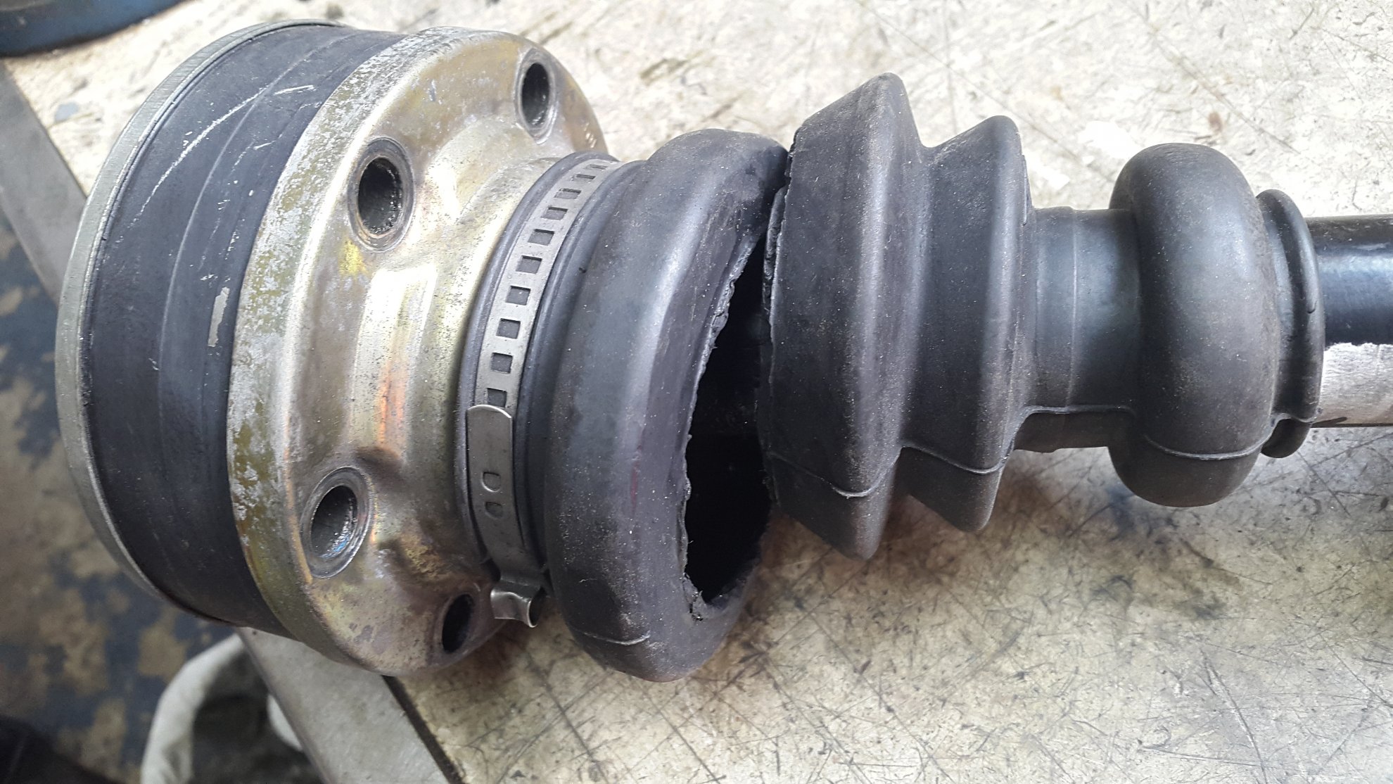

I have used my GT40 replica on road and on trackdays since 2007. I use a Ford 302 with dry-sump coupled to a ZF pantera gearbox (in Pantera orientation).
I like yourself wanted to mount the engine as low as possible. Thus ended up with the bottom edge of the flywheel flush with the lower surface of the chassis. This resulted in the CV-joints having 12-13 degrees of angles in ride height, and this has given me some problems.
1. The CV-joints gets really hot when driving on a track, this tells you that some of the power from the engine will not reach the tires.
2. I did need to replace my first CV-joints (from a BMW 3.0) with specially made ones from Driveshaftshop.com since the ball carrier did break
3. I have changed the rubber boots a number of times since it rubs against itself and against the driveshaft, eventually through and splatters the grease around.
This summer I needed to change 2 rubber boots after a track-day, and when cleaning out the old grease I found that one of the specially made 800 HP capable CV-joints had some pitting damages, probably due to too high ball velocity.
So I would suggest that you aim for much lower angles than I have, just a friendly advice.

Hi Karel

Did you made the bolts holding the lower rear suspension arm captive. If i bolt the bracket back on id just loose all the width gained in cutting the box section down by half. Did you tape a thread and use shorter bolts, im considering doing this ad welding the bracket on as well
Just modifying my gearbox and chassis to get the whole unit lower
Karel
I do not know exactly what did my workshop. I have to ask they, but they are now out in bussiness. If i can find any clue I will return to you. Sorry Phil
