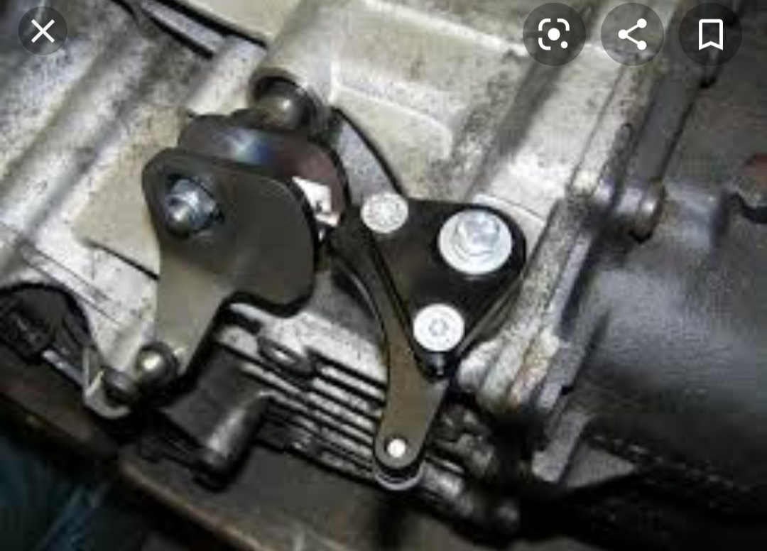

Contact Scott at Advanced Automotion for information about the 01E. I have converted them to cable shift for mid-engine use. Send me a PM and I can send you some photos.
I did like this !
Very neat, looks like the cable shift is very practical then. I am planning to change my 016 in my GT to an 01_E due to the benefit of better ratios.

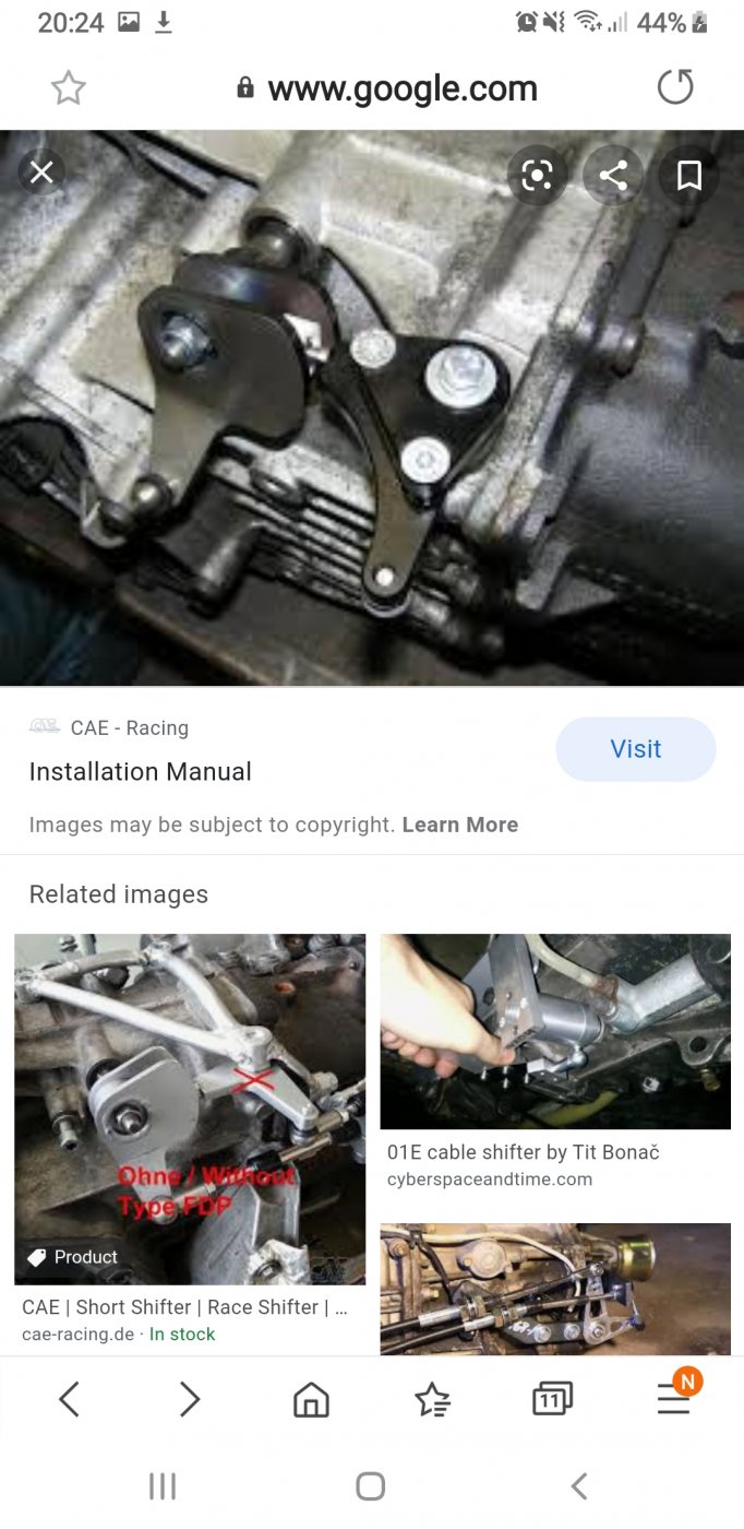

Im new to the forum from Spain, and im building a kitcar (imposible to find parta in Spain) Im currently using the Audi 01E gearbox with a duratec engine, but I would like to find the cable linckages and gear leaver ( as attached) for a rear wheel drive position. I can only find full kits that cost a bomb, just looking for the leavers.
Any ideas of were I could purchase them?
