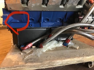

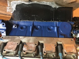

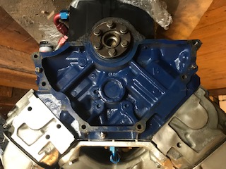

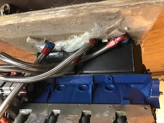

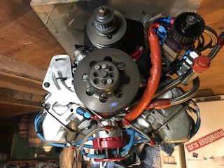

Hi All,
The seller of this engine is having difficulty finding any casting codes etc.
Does anyone know where they should be on this engine?
9.2 deck SVO block but he’s unsure exactly which one it is.
Chris
Nothing stamped into rear face of block in third pic @ 9 0-clock or in top pic the area just in front of bellhousing bolts and to rear of rear coolant drain?. Pretty sure mate with nascar stuff has two similar engines, are the core plugs hex drive in center?
I’ve asked him to check there also and let me know. I think someone has gone ballistic with paint and covered a lot up at some point.
It is a nascar engine, just am trying to find out the age/type of the block. This one I feel is the G351 non Siamese but I need to be 100% sure.

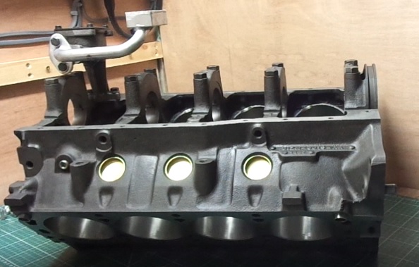

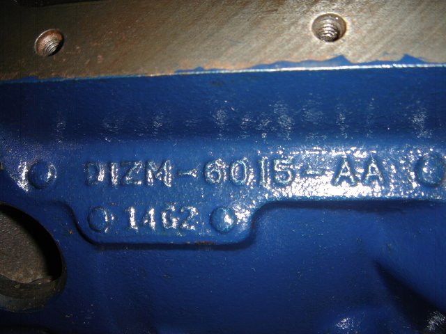

Here is the block code for my engine... and below the bare block upside down with the block number visible on the right. Ask the owner to mask that area and use some paint stripper and then wire brush away to reveal the number. A close up photo of the revealed number and its easy to ID.
