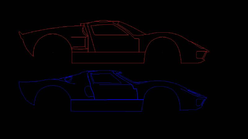

I have CAD drgs of the MKI & MKII bodies if anyone wants them. They are not completely accurate but are good enough for body fitment as wheel ctrs, body height door location etc are correct.
Forgot to add jpeg

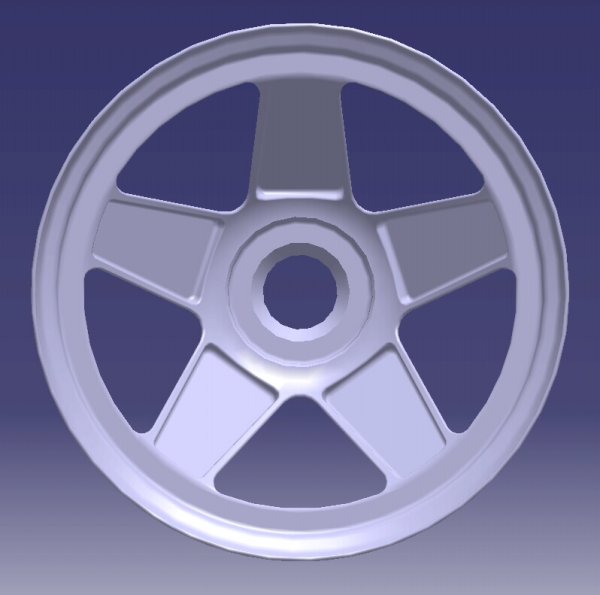

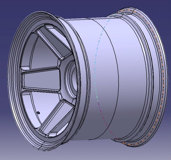

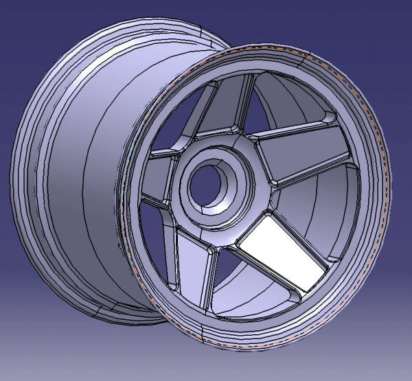

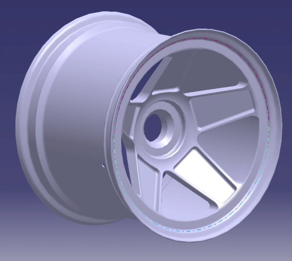

Hey guys, I dont want to throw this thread off track, but I wanted to get a bit of feedback...
I have been drawing some wheels lately, and I liked the idea of a deep wheel with an old Cromadora or Campagnolo feel to them. Possibly for Gt40/Lola etc replicas, or whatnot (could be good for the RCR P4). This wheel is drawn in a 17x12.5 size.
If you guys like this type of thing, let me know, and if I should put this in a neew thread, i will do that too.

Eric,
You'd probably get more exposure for the wheel in a new thread.
I think it would be neat to have a Campy look-alike, yet have it deal with the kind of characteristics (like larger positive offsets and diameters) that are popular today.
Aaron
Eric
Eric,
Nice wheel design and great chassis project
keep it up
Italo
