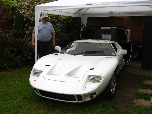

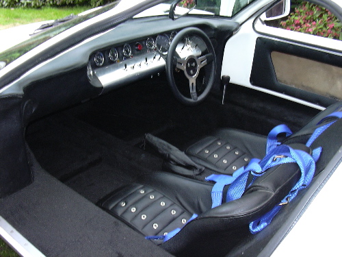

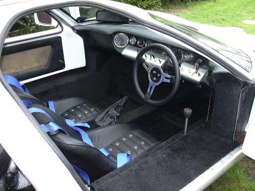

What a difference a few days make!
First a view of the car with screen fitted - perfect fit and now with wiper and squirter

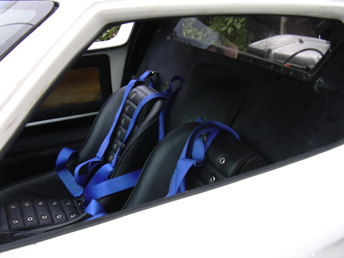

Next a view of the SVA belts (need longer neck bolts)
Interior from left
Interior from right
All of a sudden it looks like a functioning car - now where are those wheels? Paul due to get his new set this week and I'll get mine back on and align lights etc. Hell I'm excited!!!!!!!!!!!!

Yes it is perspex / plastic / acrylic (Sorry not up an how the differences can be checked)
Likewise window on rear clip is plastic / perspex / acrylic
I believe unless it is e marked glass it will not get SVA (may be wrong as I have been on numerous occasions)
