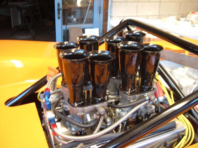

I wonder if any of our English mates are running Rover v8s with 4 x twin choke 40mm downdrafts and could tell me what jet sizes they are running as they are not cheap at $12.00 each x 8 carbs to get wrong.
My carbs came straight off an Alfa 1700cc ( 2 per car ) and are jetted just about right but do appear rich low down and cackle nicley on over run. The pipe looks the right color and the sound is just spot on.
