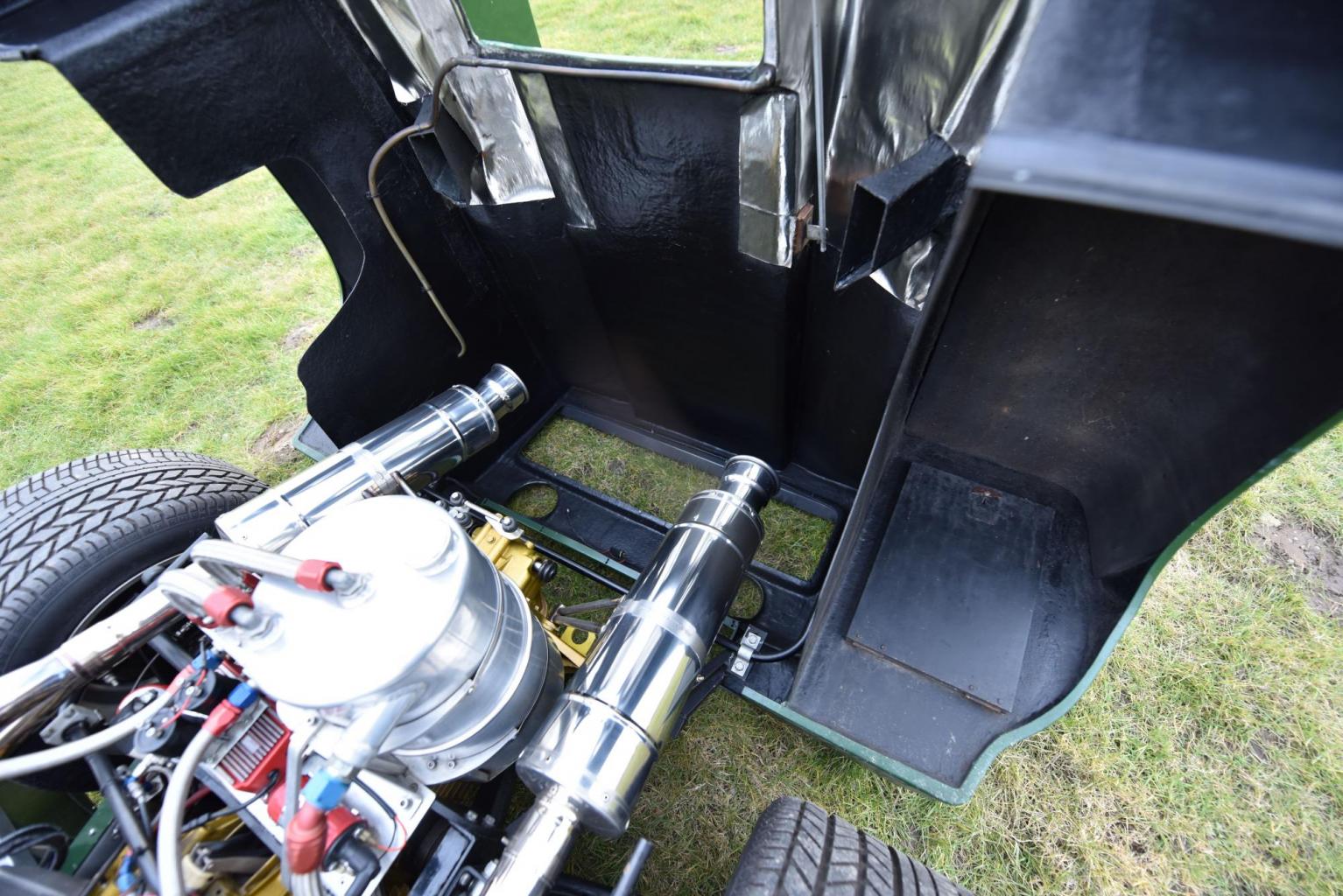

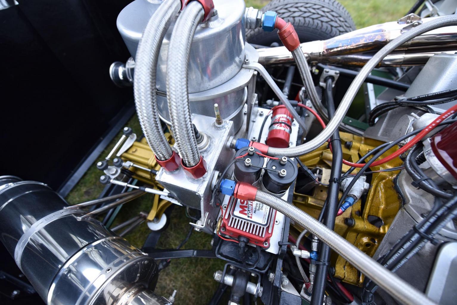

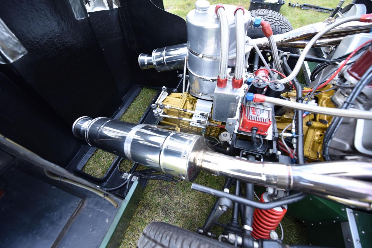

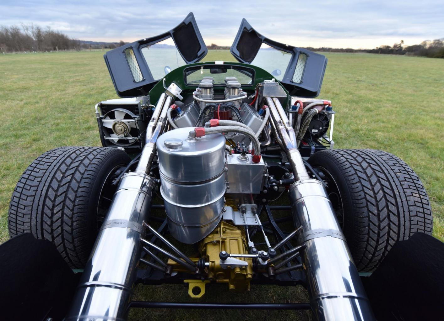

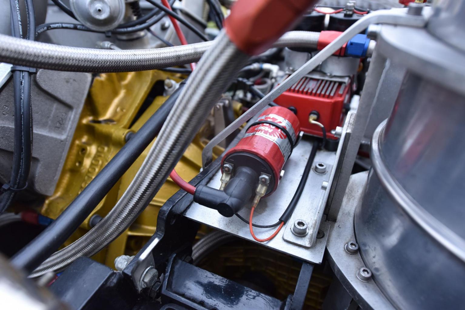

I have to say, it's a really impressive car..replica or no....
Fantastic ! Many thanks karl...
Few shots of this splendid car, recently sold again in UK.
