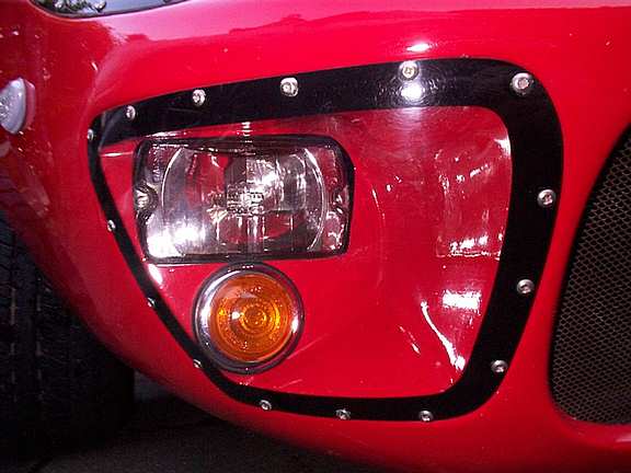

Paul, watch this space, I'll post a picture of mine shortly. I think they are Cibie, and might fit the bill.

Paul, they're Cibie Iode lamps
hope this helps you.
regards
Dave

That looks good, I reckon thats what I want to do to mine. The proper sidelight fitted does not seem to be of much use if sidelights are in the headlights already. I do like to see where I am headed! Nice one.
Murray

Hi Paul, just took one out to get the details.
In the middle of the lens it says CIBIE IODE and two numbers or a letter and number which are difficult to determine. probably 35 or maybe 25
Left top corner it says SAE02 and right top corner from top to bottom HR then E2 then 150. It has a domed back cover and a threaded securing rod with swivel at the top. Overall dimensions about 150mm wide and 90mm high.
Hope this helps.

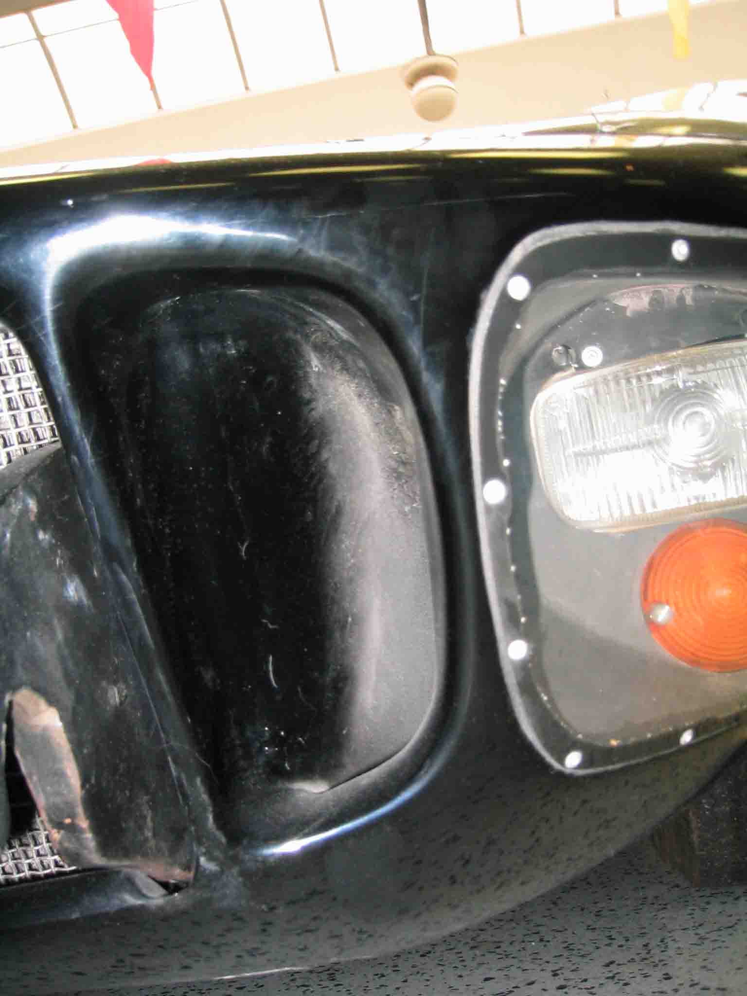

I know that everyone here is probably MKI oriented, but I have attached a picture of chassis #1032 just incase anyone else is of the MKII persuasion like myself. I am almost positive that the turn signals are 65-66 mustang. Not sure about the fog lights though.

Lynn Larsen
Lynn Larsen
Hey all,
We did discussed this general subject in the "Historics" section. See this thread: Front Side Marker Lights
You will see there that the place to find the actual lights used is http://www.vintagemotorspares.com/
The turn signals are Lucas lights in the L4xx family. The L488/471 we discussed as being the side marker lights are nearly identical but have a flatter lens; whereas, the turn signals have a conical shape to the lens. When you go to Vintage Motor Sports Spares, you will see what I mean.
