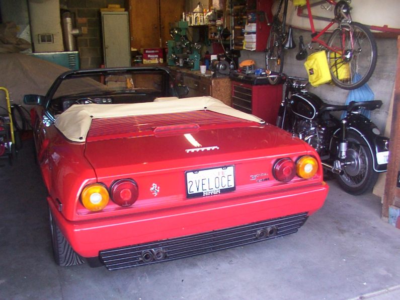

Hi Jimbo, I also have a ferrari Mondial ('88 3.2QV) cab and love it as well but it doesn't come anywhere close to my CAV with a 350hp 302. I think the difference being (other than high torque for the CAV and high hp for the ferrari) the weight - 2,300lbs for the CAV and about 2,850lbs for the Mondial. That weight delta makes a major big difference in performance. But, with the Mondial I can pull up at the restaurant with the wife and kiddies in back, top down, and, get the primo valet parking right in front - that's fun. Perhaps the most joy comes from the variation between the two but both will get you down the road pretty quick!

Before this becomes Ferrari Chat, feedback from Kevin would be in order ;)
