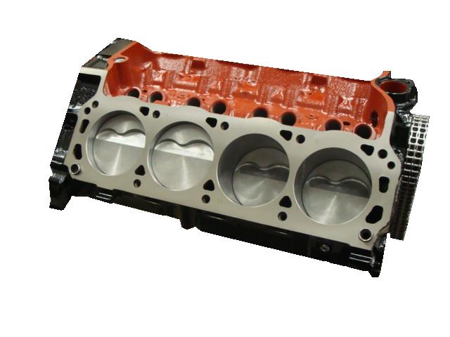

flatchat(Chris)
Should look like this, Intake valve reliefs to the top front on the right bank and exhaust reliefs to the top front on the left bank --then be sure the rods are on the right way around
