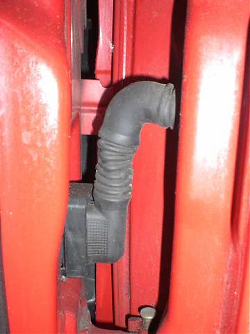

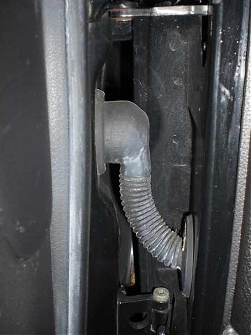

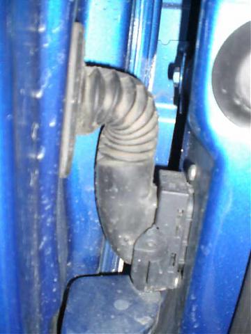

on my GTD, the builder had used a Renault (I think) door connect system - two mating plugs with bulkhead fittings and rubber sleeving - ok so you have to get it from a breakers and use the wiring colours that are pre-installed - but its designed for the job.
Something like these? Scenic, clio and 206.

Thanks guys, that gives me some options to look at. In Simons pics, the second one (Clio) looks about right, and the Pauls longer Metro one could be good if the Clio one isn't long enough. So I will check the length I need, then check out metros and clios in the breakers yard.

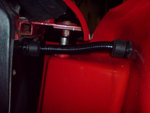

Well, with no let up in the rain, I gave up on squelching around in the scrapyard, and got some convoluted tubing from Vehicle wiring products in Derbyshire. The tubing is nylon, so ought to last, the other thing I liked was the bulkhead fittings which seal well and have a self locking tab to prevent loosening. Shown in pic with door fully open.

Nick, so far so good 2+ years, a trip to Le Mans being the major event, well sub-zero temps here in the winters. My take is it is ok, but even if it cracked now, 'tis easily replaced. The fittings seemed good quality, the whole thing seals well, and having taken care to ensure that it doesn't get stressed adversely during flexure it seems to do the job.
