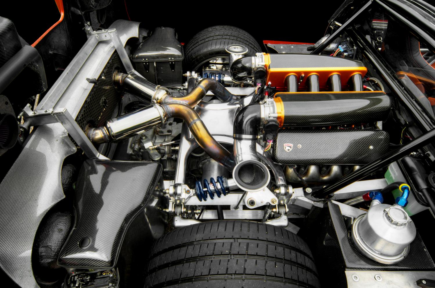

Found the intake and exhaust I will be getting
This is the most beautiful engine bay I have seen in an SLC. Its not really practical but I want that intake. I also want that exhaust setup. Anyone know who made this and is that exhaust available for purchase?

That is the Falcon, not an SL-C. The chassis is based more or less on the SL-C but has many bespoke parts on it. The GTM forum on FFR site has many pics of the car.
The intake is Performance Design LLC. intake made here in Metro Detroit...available for any LS based engine...
We make many of the billet parts for the intake and it is beautiful piece...
Performance Design
The exhaust is a modified Kooks piece and will not even come close to working in an SL-C...sorry
Caleb's intake is awesome - when I was doing my 502 my intention was to use it. Sadly it never panned out :( (because of my sh1tty engine builder, not because of Caleb - he was fantastic to work with)
Fyi, if you use it in an sl-c you'll need a custom rear cover to clear the plenums, plus you'll need to lower the engine and have Caleb modify the plenums to clear the spyder section of the chassis, then draw air from the roof scoop to it and filter it. it's all do-able and we had a plan, but it unfortunately isn't a simple plug-and-play in an slc
Hmmmm...I should have looked closer and I would have seen the Falcon emblem.:embarassed: Bummer on the exhaust, it looks great.
Thanks for the info Alex, I will keep looking.

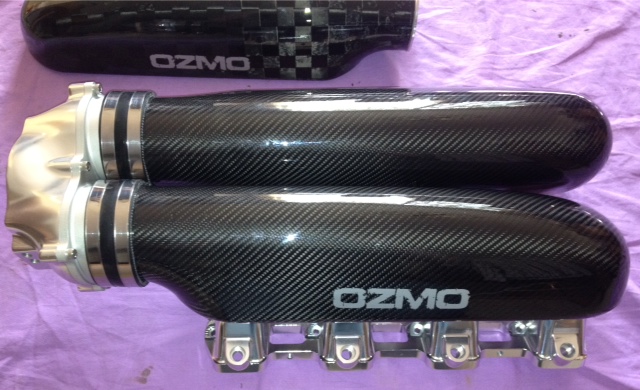

Here are another two from a company called Ozmo. They both look shorter than the Performance Design unit.

I checked out Performance a while back, but they don't make anything for the LS3. Your credit card is going to take a pounding if you do go this route:
Last I heard the ozmo carbon fiber ones kept cracking because they couldn't handle the expansion of the block after it heated up.

Thats a bummer about the Ozmo, hopefully they figure that out. I like the single TB version, its simple and clean.
