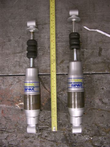

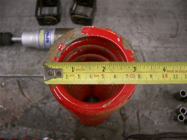

Here are pictures of the Spax dampers & springs that are standard fit for GTD. The dampers are shown fully extended, the longer ones being the rear.
Hope you can get what you need from the pictures.

I thank you as well Julian. From the photos, I gather the front springs are 11" and the rear are 12". Both appear to be 2-1/2" ID.
The shocks appear to be 15" and 16" extended. Is that correct? What about springs rates for the front and rear?
