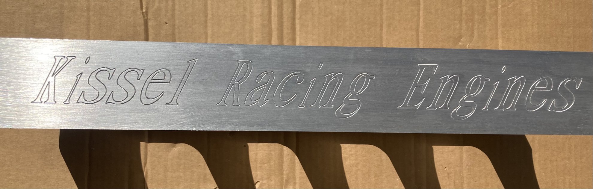

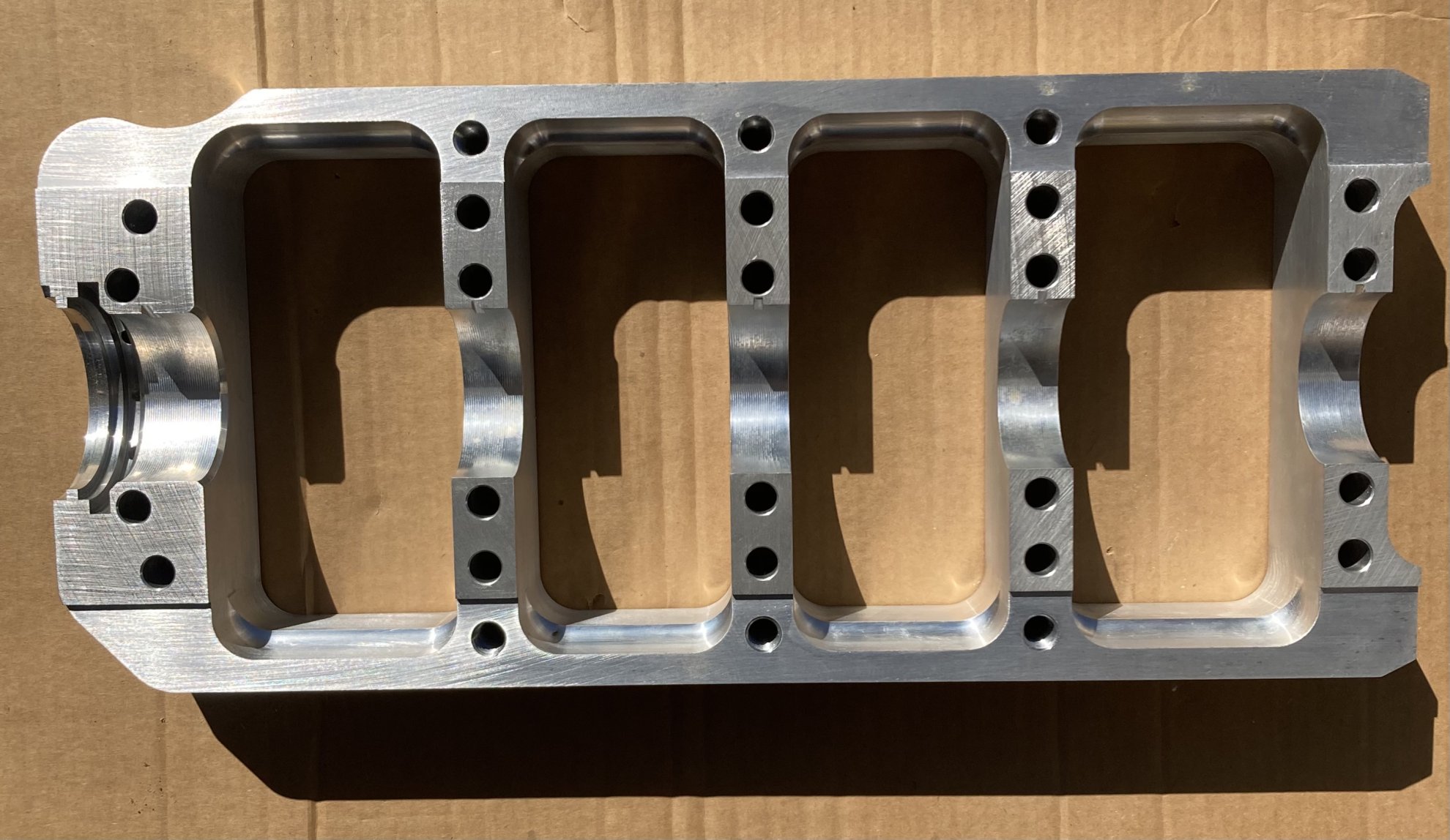

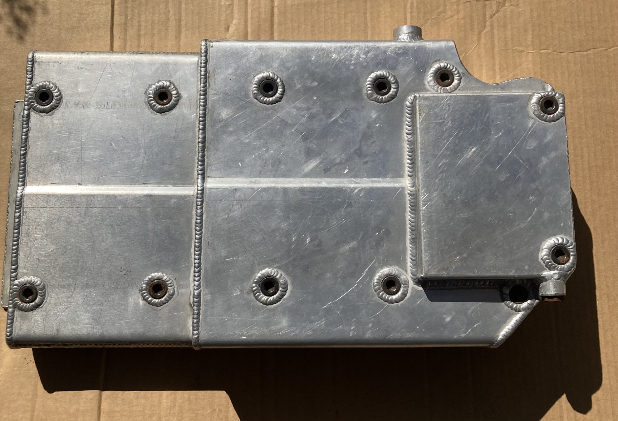

Back in the late 80’s and early 90’s, I made these for the Big Block Chevy’s. At much over 1500 horse, at a minimum the caps were walking or they were blowing the main caps off the block. My girdle tied all of the main caps together as a unit. I also had special oil pans that worked with the girdle as well as a cast timing cover with a large bearing to support the crankshaft to help prevent the end of the crank breaking off. I made these for the Rodeck block as well. The technology has been around for years.
Regards Brian

Ryan, not to my knowledge. The ones that are being shown in this thread just covers the main caps with a 1/2” plate. My unit was over 2” thick and all the main caps along with the sides were one piece. ARP made me custom sets of studs for it as well. I also on the side web milled it so it acted like a crank wiper to help peel the oil off the rotating mass. Real crank wipers are meticulously machined to close clearances around the rods and crank. This was the best I could do and maintain the one piece option as everyone’s assembly was different. The bottom was o ringed and mated to the timing cover as well. The oil pan was shortened in height to accommodate the height of the girdle.
Regards Brian
