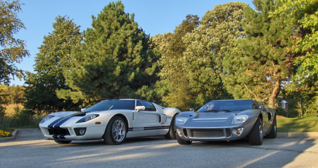

In the first picture below we have our customer, Angelo between his two (now three) GTs. The Gulf car is the first CAV GT in Canada and was initially set to 4 inches front and 4.25 rear.
We always put a bit of wedge in to lower air pressure under the car. Angelos car has a dropped drivers floor pan so it's under three inches on that side. Surprisingly, most speed bumps are not a problem, nor railway crossings or general road conditions.

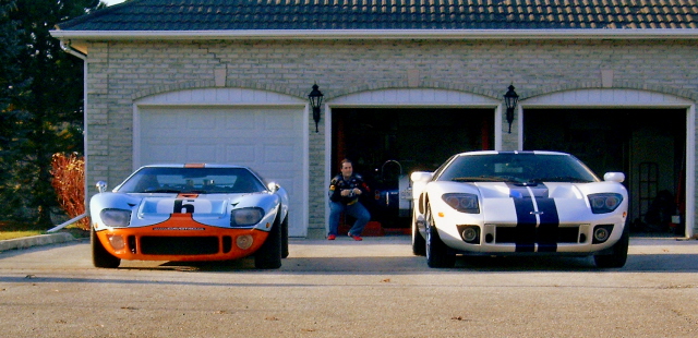

The second picture is another customer car, Chris S. His CAV GT has since been fitted with the dual nostril nose and is undergoing a colour change. It's sitting at 4.25 front and 4.50 rear. Low enough or should I say high enough!
Anyways, as long as they're sunny side up, all GT40s are gorgeous.
