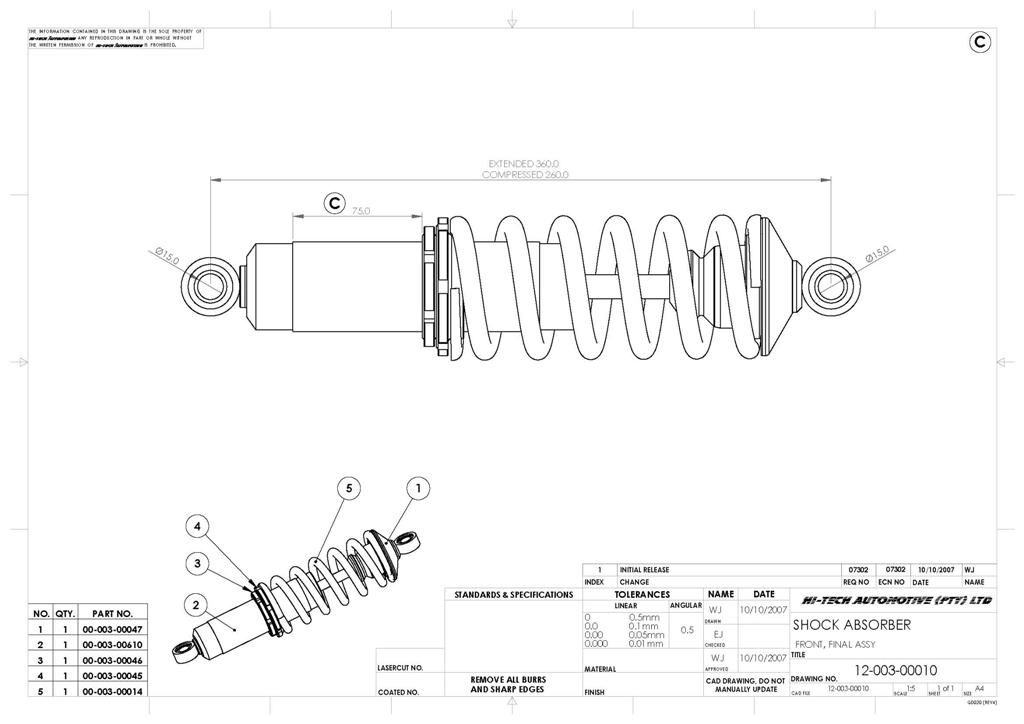

I am not an engineer, but usually the spring is the first thing that MUST BLOCK to protect the coil over. If the coil over goes on block first, it can break and based on the design, if it breaks, you perhaps loose the whole wheel...Nice idea
XXXXXXXXXXXXXXXXXXXXXXXXXXXXXXXXXXXXXXXXXXXXXXXXXI am not going to explain you, how to draw pictures with all forces working on a suspension, read a book.
But the more you move the coil over away from the hub, the more load is going on the suspension arm it is mounted to, and you need to increase stiffness of the material or change the design to carry that additional load.
What we see here on the LEFT side is a bend over time because of the weak material you have chosen. I assume ( not saying it was) that the bend on the right side was the same until the car was approaching the mentioned curve on the ring and then got bend more based on the high load. This explains the different amount of bending we see.
Your suspension arm design is bad and the material you have chosen is not up to the job, not even for street use.
You can call me wrong, but pls do it like an engineer, put facts, drawings and calculations on the table, keep your wrong assumptions for yourself.
And pls don't forget to send us a picture of the improved parts you mentioned.

(C)arlos, the statement from you in the above post is totally incorrect, The coil spring should NOT go into BLOCK or COIL BIND, to do so creates an instantaneous shock load thru the coil over to both the bottom arm and chassis points at which the coil over mounts, coil overs usually have a rubber or soft compound buffer fitted to the coil over shaft as seen in the attached photos, if not fitted then you must fit a rubber 'bump stop' to some part of the car chassis or suspension arm to perform this function. I have read both this thread & your build thread....you chose to not use the Tornado spring damper units, but sourced & fitted the ones on the car yourself, given the above statement its obvious you made a bad choice & chose/fitted a spring that was/is totally unsuitable for the application, under the circumstances you should perhaps be thankfull that the bottom arm failed in the manner it did. Would not matter what type of bottom arm was fitted, if you use BLOCK or COIL BIND as a travel limiter in any form of suspension it will eventually cause further damage or component failure. Looks like you might be the guy who needs to read some books!
