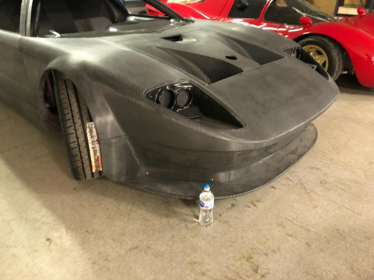

So far I can make, Fog light buckets carbon or GRP, wheel arches, tail lights, Carbon head light buckets.
In the works are, door cards, some what of an OEM style center console and engine cover hinges.
