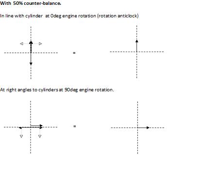

In theory, if the reciprocating weight changes, the engine would need to be re-balanced.
BUT
In practice, remember that we are balancing a reciprocating engine, where the intent is to do the best we can under adverse circumstances.
What I mean by this is, (for a single cylinder) that balancing the reciprocating forces in line with the cylinder, introduces imbalance at right angles.
So starting with an unbalanced engine, we will have 100% reciprocating forces in line with the cylinder, and 0% at right angles. Balancing out all the reciprocating mass will give us 0% in line with the cylinder, and 100% at right angles, so we would be no better off.
So the best we can do, is to balance out 50% of the reciprocating mass, so that we end up with 50% forces in line with the cylinder and 50% at right angles.
The rest is down to number of cylinders and configuration, and how the additive forces from individual cylinders cancel. In our case we have static balance and a large couple unbalance to deal with, but no matter how you cut the cake, you can only achieve a 50% balance, not the near perfect balance you can achieve with a purely rotating machine like a turbine or motor.
Taking that into account, my guess is that you can get away with quite a lot without noticing a difference provided that you end up within 10 or 20% of the optimum.
As far as the difference between internal and external balancing is concerned, a 50 oz.in moment at 6000rpm translates to a rotating force of 3190lbf acting at the flywheel, so this introduces a bending moment in the crank that is not there in an internal balance. Provided that you aren't near the critical speed (which you won't be) this won't make any practical difference to vibration. The force may seem large, but given that external balancing is the norm, I guess that it will be quite small in terms of crankshaft stress.

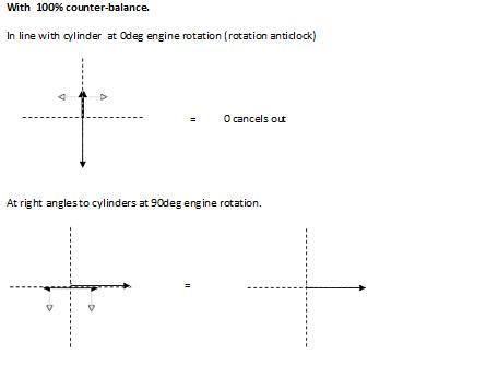

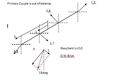

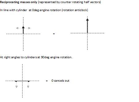

So where the need for external balance comes in, is for the reciprocating masses. In the 90deg V8 configuration, these result in a residual rocking couple (as per my previous diagram) that is countered by the 50 oz.in (or 28) external balancing.
However, there is another really important point that needs to be appreciated to get a more compete picture. Because the reciprocating forces are in only in line with the cylinder, and any balancing we do has an effect at right angles too, the best we can do is to balance 50% of the reciprocating masses. If we balance 100%, we only swap the balanced forces from in line to at right angles. By balancing 50%, we reduce unbalance by 1/2 and that is the best we can do, if we go further, all that happens is forces at right angles increase and the balance gets worse. How the forces ultimately balance out is down to engine configuration, in our case we are left with the rocking couple, so if we do a 50% balance and end up with a 50 oz.in counterweight, then there is still 50 oz.in left in there that can't be balanced. This is true whether you go internal or external.
I can reinforce this point by looking at the balancing process, which is to add counterweights to each throw. These counterweights are typically half the reciprocating mass, and yes, with the counterweights on, we can balance it down to 1gramme or whatever, but there is effectively 50oz.in still left in there, so what we are actually doing is balancing to a residual of 50oz.in, with an accuracy of 1 gramme (0.2 oz.in on a 5in radius).
I should explain that I have many years experience resolving balancing issues in our factories and global service centres, from small 15000 rpm down to 10ft diameter 120rpm rotating machines, so I have to understand the fundamentals very well.
The attached diagrams visualise the reciprocating unbalance, and the effect of the optimum 50% balance etc
