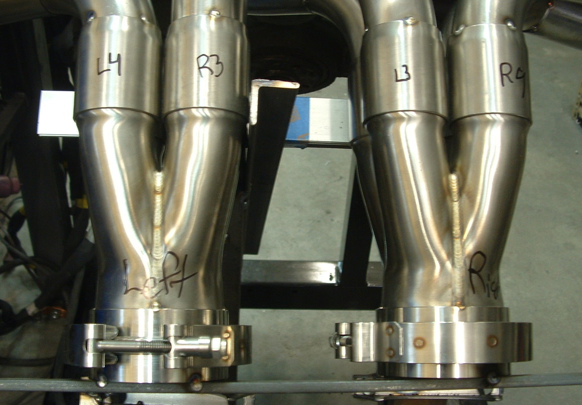

Urs,
Stainless Headers, Inc., is finishing up my system for a 351 based engine. Chris is the guy you want to talk to. They do great work and are reasonably priced, they will also send pics as they progress with your system. I had them install double slip connectors between the primary and collector for a tighter seal (o2 sensors), and a v-band clamp after the collector so I can easily switch between mufflers and megaphones. Turnaround time was a week for me. Stainless Headers Mfg
You can reach Chris here: [email][email protected][/email]
Good luck!
