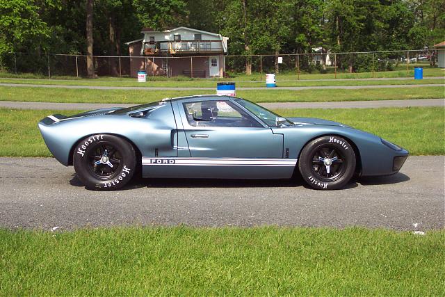

How did the origional cars appear lower in the rear
Maybe some of you can help. I can't help but notice on early MKI cars that the tires on the rear fenders appear to be more "inside" the fender wells that gives the car a lower meaner stance in profile. What is different about the current replica cars that make that wheel well appear higher? For example the Comstock GT40 and others have that low-slung look that I am after. If you look at these cars you will see what I mean.
I will look forward to hearing from the experts.
Garry

Suspension set up, transaxle choice and geometry.
Better if you could provide examples of replicas that don't sit the way you desire,
you might see a commonality in their set up.
For example, ERA and Superformance seem to sit just as well. Many CAV pix are of
cars without engines/transaxles, so they appear to sit higher.
I think you will find that the original 40s had a different shape wheel arch that lowers the upper edge of the wheel well.
Early cars typically had tires with a much higher profile than today's offerings. As a result, the overall diameter of the tire is larger, filling the wheelwell much more.
I also believe that the racecars would be carrying a considerable amount of negative rear wheel camber which would also add to the effect of the wheel being further inside the arch. When I say considerable - for the rear that would be more than 1/2 degree negative. This also adds to the more squat look of the car.
Dimi Terleckyj
Hi all
I think that another contributing factor would be that the racecars were able to have a much lower ground clearance than we need or are required on roadgoing cars.
I know that here in Australia we have to have a minimum of 100mm to the lowest part of the car to be legal and also to clear all the speedbumps and bad roads.
Dimi
Yeah, there is a big difference in the way the wheels sit in the wheel arches on the different kits.
It comes down to body shape and obviously suspension setup and mounting points on the chassis. And this varies significantly between a lot of the GT40 kits.
In my opinion the more authentic the body shape etc the better the wheels sit in the guards.
But others have different views, which is great.

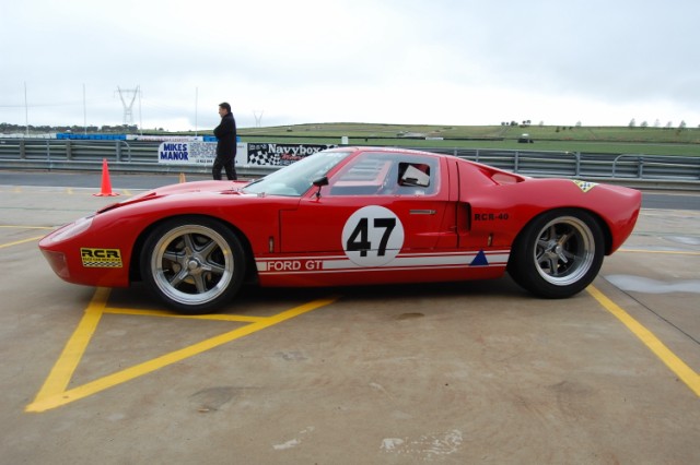

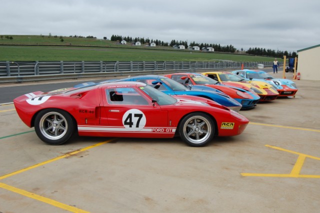

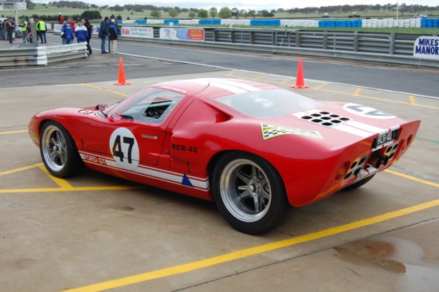

This is how an RCR sits with 115mm clearance front and rear. This one is fitted with 680mm diameter rear tyres and 630mm front tyres. They are slicks. With the tyres up tucked up nicely in the wheel arches it certainly makes the RCR-40 appear low.
And they are 17" wheels.
Interesting it looks just as good with rears of 650mm diameter street tyres(315/35R17). Just can't find any photos of the street tyres fitted.
This is also an RCR-40 with standard guards. The +2" & +4" guards options on the RCR-40's look just as good, some would even consider the larger RCR-40 guards are more attractive.
Maybe if we can get more photos of GT40's with known ride heights and wheel diameters.
Hope this helps.

Thanks mate. I was really surprised it looked so good with standard guards and 17" wheels. By the way it is still in gelcoat with just stick on vinyl stripes and graphics.
The large diameter rears fit easily. I think with most kits you will have no problem running large diameter rear tyres. Normally the problem most people here have is finding tyres with a large enough diameter.
The front is where you have the problem. The more authentic the front guard shape, the less room there is for tyre diameter/width. There is always a trade off.
Even though there is different body shapes, they all have their advantages and disadvantages. So really there isn't a right or wrong answer. Basically repeating what Darrell said above.

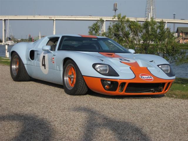

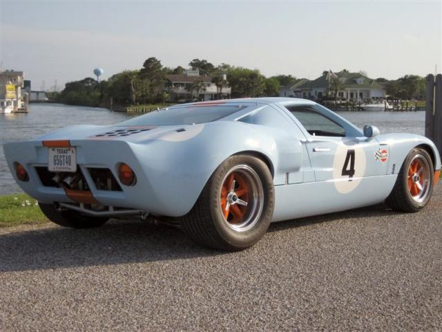

Here's my RF with Gulf flares.
