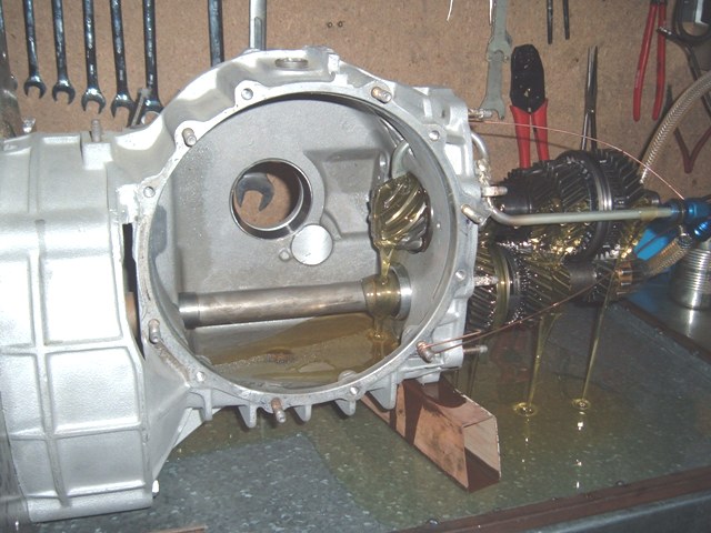

Much appreciated! But, I did the exact same experiment on my own tranny last month and posted photos too, only I can't remember where I posted them. I came to the same conclusion that you did though.
Ah, I never saw that, I would have thought this thread would have been the appropriate place to post that...
Did you guys break something to make you take it out of the car and tear it down?
C'mon Ron, you know better than that! ;) These trans don't break! No, it was all good, just fitted some closer ratios as I found I never used 1st and 4th was miles too high. Standard ratios are ideal for a road car though.
Posts #24 & 36 this thread..........................................:thumbsup:
