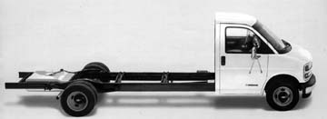

PS - found this, how much would one of these cost for me to build out custom on? I could build the entire back section and have it as low as I want etc......

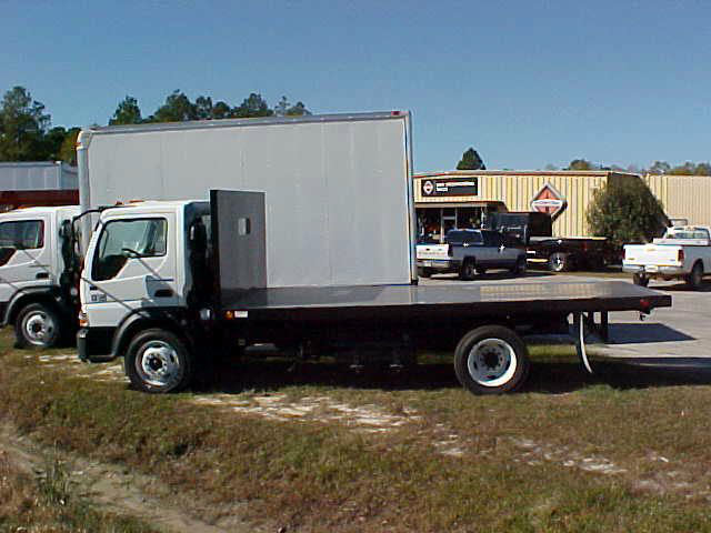

The only way around the wheel well issue with a flat floor is to have the floor height above the dually wheels...ie the waist high floor. I have seen moving companies with long lightweight ramps to load cars into their semi's, however I still think they won't be long/flat enough for race car ground clearances. There are also hydraulic lift gates that fold down and will lift up to 5000#. That is how most of the "Stacker" trailers deal with multilevel car trailering.
I have a 2006 international CF500 with a 8'wide by 16' long box, flat floor, and translucent roof, in dash GPS with integral color backup camera that would be perfect....you would have to add the lift gate though.
I had thought about this as well. You could mount a generator and air compressor under the box to the chassis rail on one side and some big tool boxes on the other. The CF500 is 22' overall, you can park it anywhere you can park a crewcab dually, but the turning radius is SIGNIFICANTLY smaller than pick-ups or cutaway vans. Plus it has the v-6 version of the Ford Powerstroke Diesel engine and a nifty 5 speed auto.

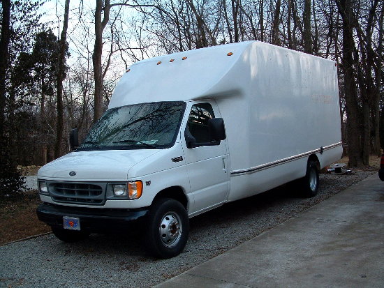

ohhh, like this? I saw the ultra tall ones, but one like this would allow me to build a low roof etc. that would allow the rig to get under a 9ft door. Only problem is, these things aren't cheap!
Holy smoke, Chuck, that would be it!!!!
I need to research this! Thanks much, that is helpful, much appreciated.

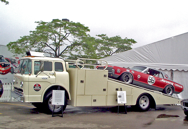

Whoa, I like that one too! Which one is worth more, the Vintage hauler or the Cougar? Always have loved Cougars.

Ron,
This is an "Aerocell" made by Unicell down the street from me, I sell a lot of them. You can do them with a low floor with wheelboxes that cover the rear duallys. Some guys use them as transports and have ramps that rest on the wheelboxes so that the floor remains flat and low while the car sits on a 10 degree angle or so, makes for easy loading and good ramp angle from the ground. I can send you info if you wish. Lots of then available used on Ford or GM chassis. They come in body lengths from 12 to 17 feet. The body is a one piece fiberglass unit with the roof translucent for light. They are made in BIG mould and the glass is sprayed robotically for even thickness.
Rick
