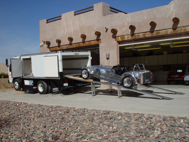

The Unicell looks good. Here is another option. Just a standard cab-over with a custom short box on the back. I would use a hydraulic lift over the long ramps though. The nice thing with those cab over trucks is the wide choice of engines you can get. Anything from a 4 cylinder turbo diesel to an American V8.

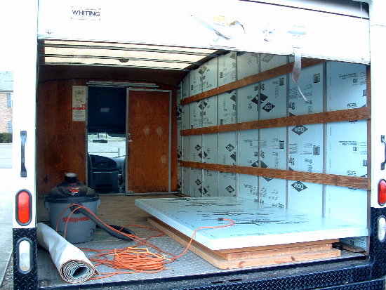

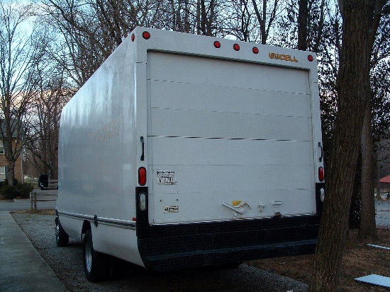

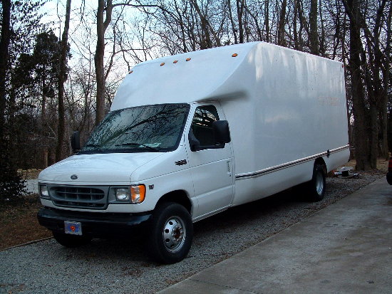

Took some measurements on the one listed over at Gasholes...floor of box is exactly 3' off the ground, unloaded. The depth of the box is 16, height is 6.5' and width is over 7.5'. So it should be easier to get a vehicle in than the cab-over above. Plus, the benefits of the Powerstroke diesel. Few more pics, working on finishing the inside:
Is it 9.5 feet tall, or a bit taller? Is quite important for what I am trying to do. I know inside you indicate 6.5 feet, and 3 ft off the ground, but a wiggle room of 6" is a lot in my case.

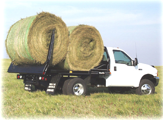

This may be a bit out there, but around here I’ve seen this setup on ranch trucks to load round hay bales onto a flat-bed. It might be possible to connect the hydraulic arm to a ramp hinged to the back of the truck bed. Drive the car onto the ramp, lift the ramp even with the bed, drive on, disconnect the ramp, and the hydraulic arms rotate around and out of the way. A used flat bed truck can be had for under $5K, and if you got a stake-bed, it would be easy to put a removable “camper top” on it as well. I don’t know the price but here’s a link to a dealer:
Hydra Bed-The Original Hydraulic Bale Bed
charlie
